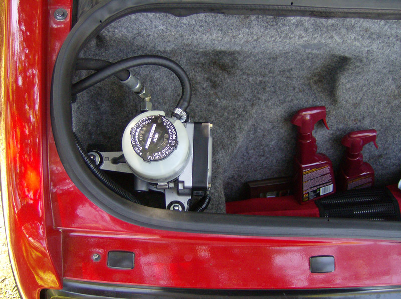

Spoon JUN 19, 11:09 PM
Originally posted by Hondo88h:
Recently bought a 86 Fiero GT. Has Link Racing power steering on it but no pump. Anyone know what pump was used for that setup? I either need to put a pump on it or if any interest to anyone sell what’s there and go back to stock setup.
Sounds like everything is in tack except a pump. Pickup a used EHPS pump and call it a day. It's all electric so no need to adapt it to your engine.
