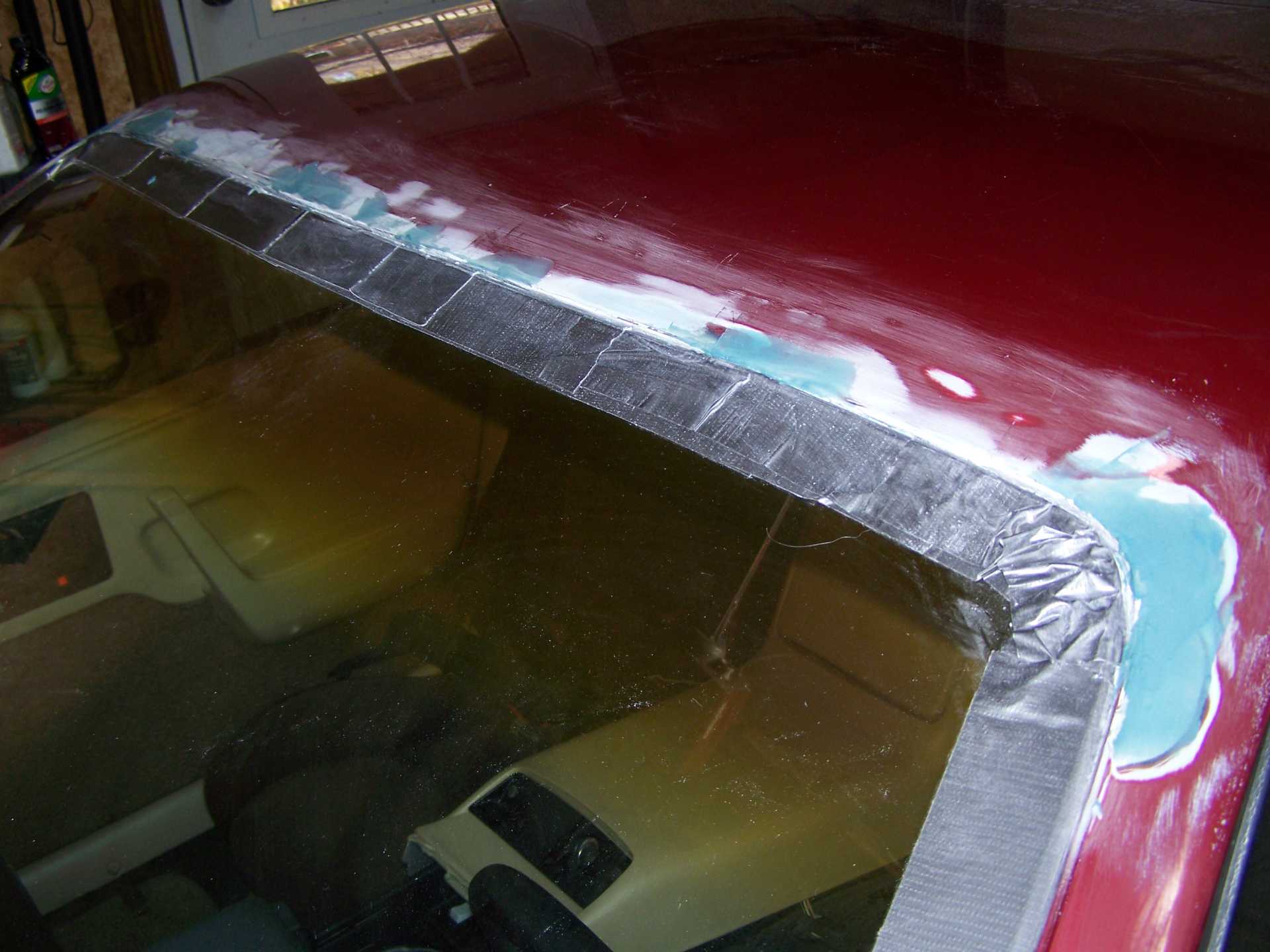

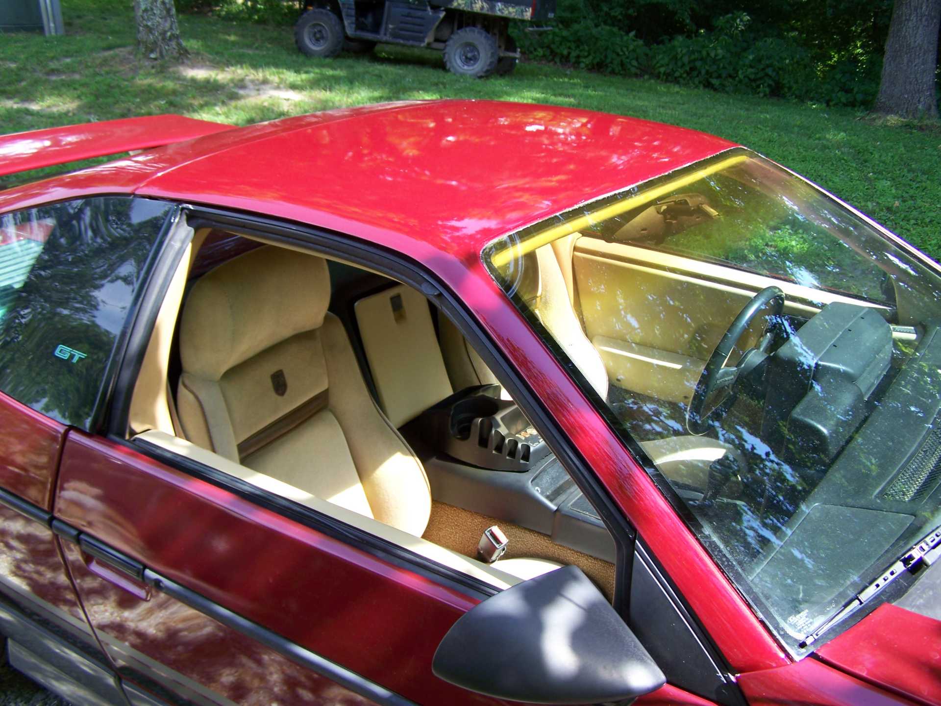

When I purchased my '87 GT the roof panel was cracked and chipped along the top and at the top corners of the windshield. I repaired the damage some time ago and have been waiting for decent weather to paint, finally got it done today. I used base coat (GM77) from Automotive Touchup and Spraymax clearcoat. It turned out pretty good, excepting that the color match is not the greatest. Also, the base coat can did not spray with very much pressure and was not atomizing the paint very well and produced a bit of spatter which I wet sanded out here and there before clearcoating. I have used the Spraymax clear before and as usual it went on great. I think that next time I will try a different source for basecoat.

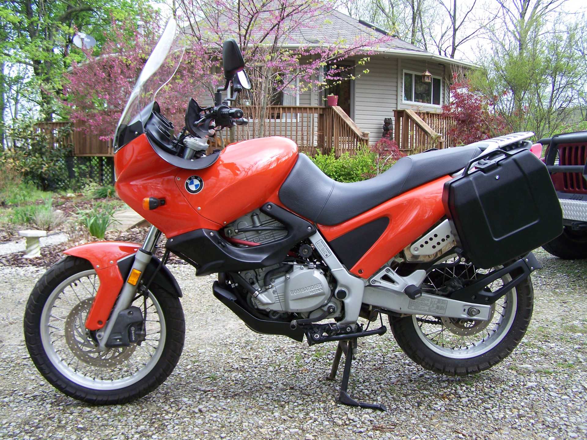

For larger jobs I do use an HVLP gun from HF. But for smaller stuff & touch up I go the rattle can route. I rattle canned the BMW in the photo with Rustoleum for the base and Spraymax clearcoat.

Creaky, did you spray the entire Roof and down the Windshield sides or did you just feather it in partway?? The job looks great to me. I have a spot more or less like that around the top edge of my Windshield ... [This message has been edited by Notorio (edited 06-18-2020).]

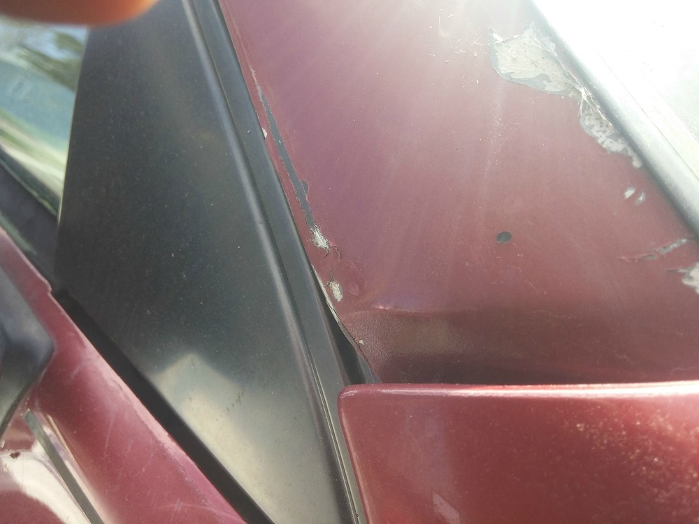

I did the whole panel including alongside the windshield. I am curious as to why the panel was damaged above the windshield. Maybe water trapped under the windshield rubber trim froze and caused it??? Ideas welcome.
Gall757
JUN 19, 09:38 AM
| quote | Originally posted by creaky78:
I did the whole panel including alongside the windshield. I am curious as to why the panel was damaged above the windshield. Maybe water trapped under the windshield rubber trim froze and caused it??? Ideas welcome. |
The SMC fiberglass will soak up moisture and expand if the paint is damaged. Usually what happens is the paint was scored when the windshield was replaced many years ago.
