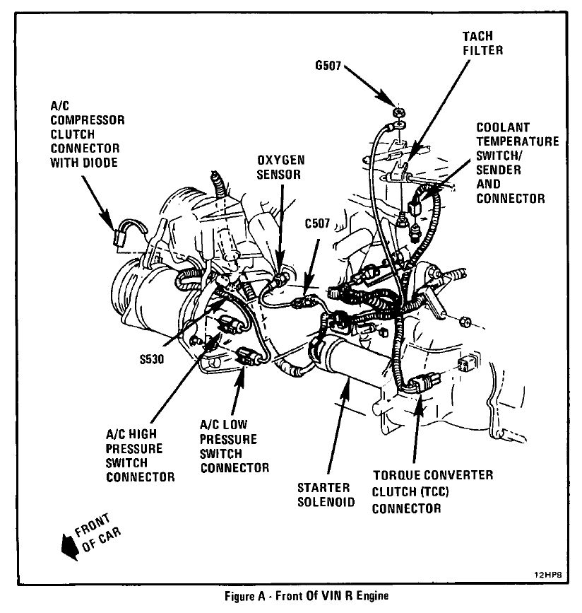

So I am Asking for a favor as I searched High and low for a picture of where exactly is the tach filter on the iron duke. I found it easily enough on the V6 fiero, but on the iron duke not so lucky. I have read that its right below the coil bolted to the transmission but for the love of me I can't find it nor see it.

The tach filter on a Duke is sometimes taped to or wrapped IN the wiring harness.
It should still be on the harness below the thermostat housing near the coil above the distributor.
I'm sure my 84 Indy had it in that vicinity.
This diagram is from the 1986 Service Manual...

thank you! we figured that was where it was but wanted to make sure before we started digging into it.
