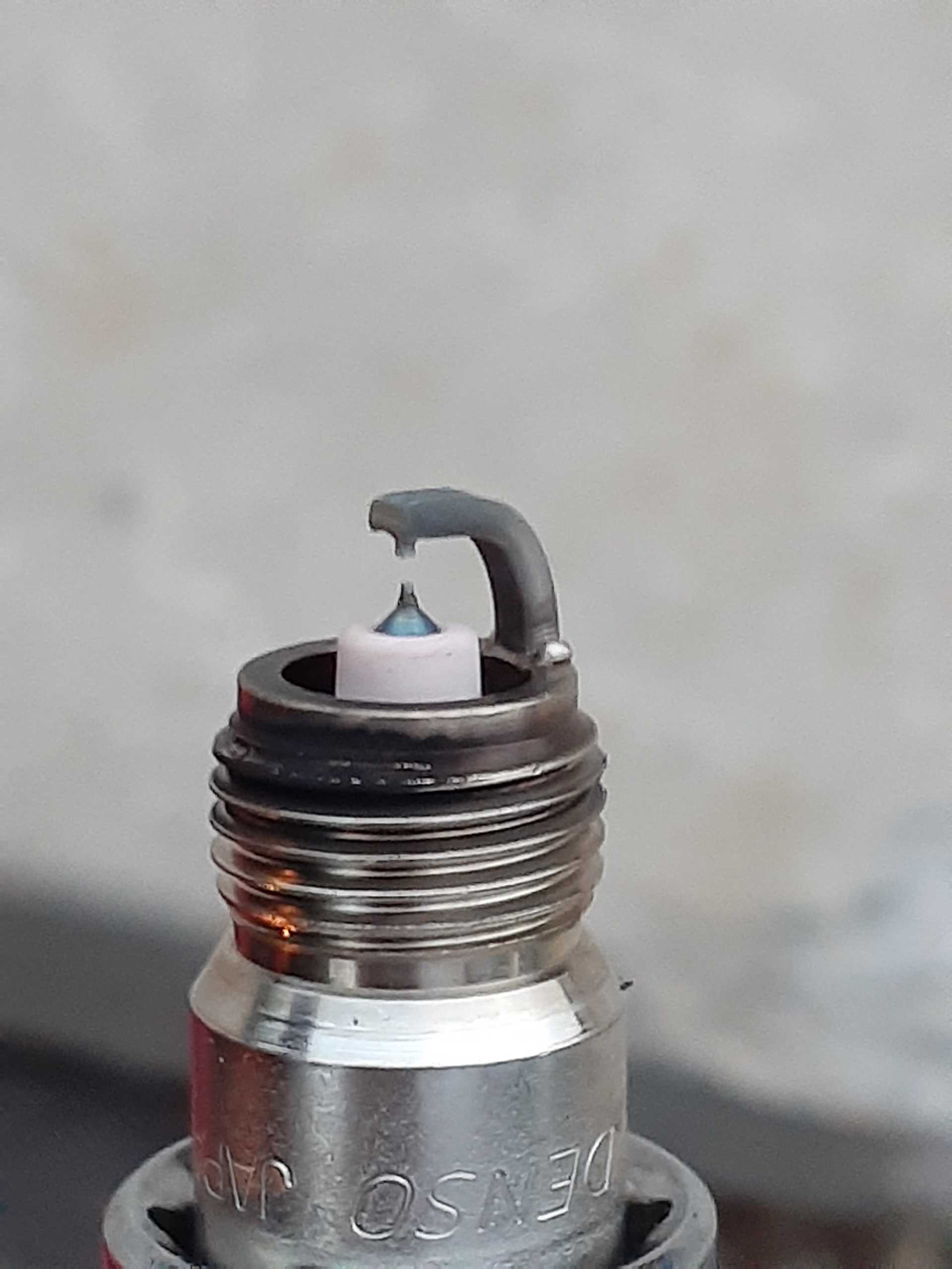

I pulled a couple of plugs last night and I think they look good?

JUN 14, 09:04 PM
By looking at that spark plug your AFR is about right. BMW injectors are the same resistance as the Fiero, I tell you because I've been using Bosch BMW injectors for a while now.

Turns out my buddy has the ALDL cable, he just needs to find it. Sounds like I will probably just log data and send it to Ryan, but I'm suprised the plug looks as good as it does. I might try taking through emissions and see what the numbers say. Maybe it's not as far off as I think?
