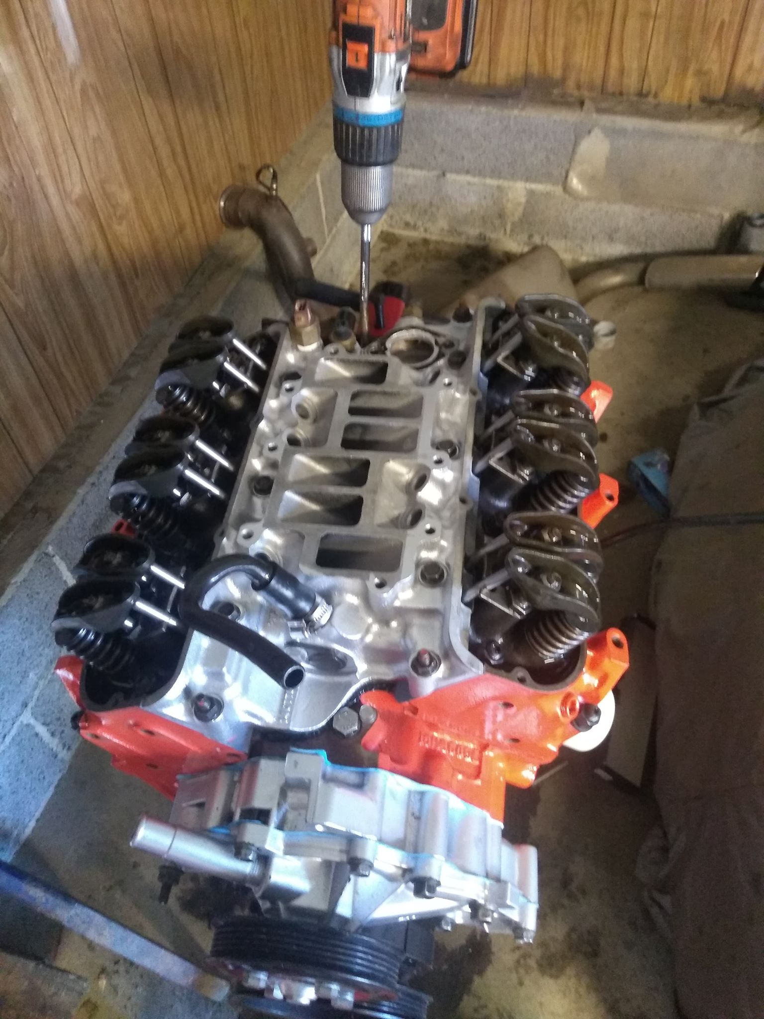

swapping out my 2.8 for a 3.4 camaro / firebird engine.
im at the point where im trying to prime the oil pump , i got one rockerarm that dosent get oil ? all the other rockerarms seems to have good flow. but not the one on cylinder number 5 ( exshaust valve )
Anyone had this problem before ?

it dosent help, have tried it plenty of times now , still no oil to that rockerarm. cam bearings was replaced by the machin shop, can it be that they are not installed correctly ? or can it be that my battery drill is not turning fast enuf ?

Thanks guys i found the problem.
When i was bleeding i was just using a extender with a socket on , when you are doing it that way the oil hole for the dis will be open , so you will have to good flow there. When the dis is inn you have something thats blocking and reducing the flow there. so I took an old dis and removed the gear that drives the camshaft , used it as a bleeding tool and bam oil on all the rockers inn no time , it only took a few seconds
