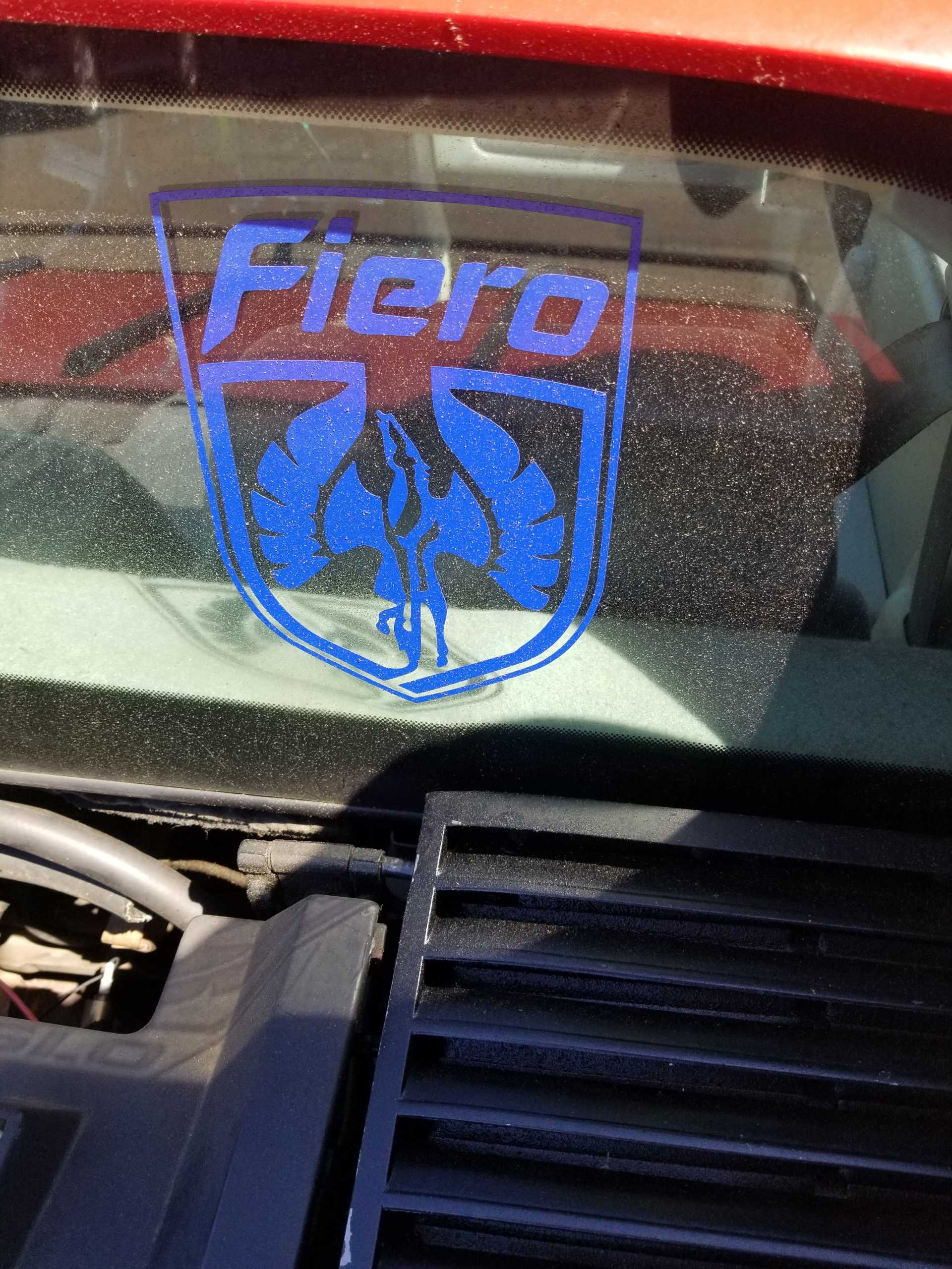

So my 84 se has been running rather well but lately I'm getting a lot of oil smoke and small bits of oil coming all the way up onto my back window and deck lid. I have cleaned up all around the valve cover and havent seen anymore buildup there in a couple days and the pulleys and belt look clean and dry. I know it has a leak but I cant seem to track it down. Any help would be greatly appreciated.
theogre JUN 06, 12:20 PM
Leaking Coolant can "feel oily" and make a big mess.
Look at the WP and hoses.
