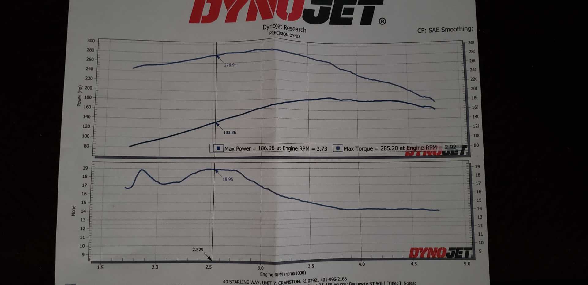

Base dyno after switching to E85...the problem was I solved my limp mode issue so now I'm lean... I had switched to E85 to compensate for limp mode. Turned out to be a bad TPS sensor and wiring...now I'm super lean.. Once this is fixed 200rwhp and 300ft*lbs should be possible. I am also running 17x9 wheels now which are 2 lbs heavier than the 18x8.5's I was running before. An old dyno when I was pig rich had me at 175/265 so with not tune I picked up 12hp just switching to E85...
I stand corrected. My old torque was at 265 so I edit the post from 275.... That means I gained 20 ft*lbs from going to E85 with no tune.[This message has been edited by lou_dias (edited 06-08-2020).]

For more fuel you will need to go into the VE vs MAP vs RPM table in the chip and increase the values but once you adjust for E85 you won't run well on std E10 gas. .
