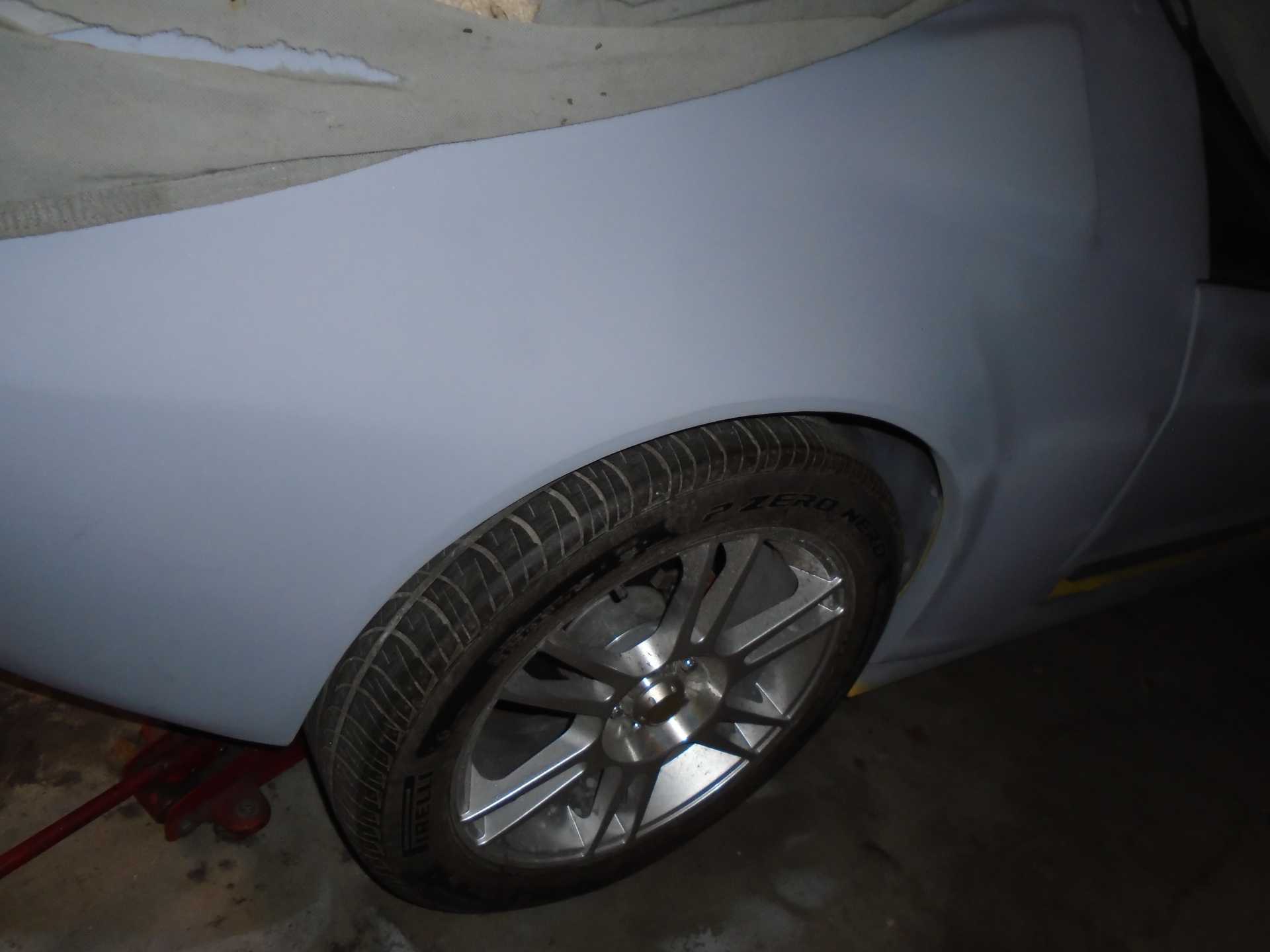

how wide a TIRE can I put on a 18" x 7.5" Wheel for the rear of my chop top ? ( i can use "spacers" if needed, because I have wide wheel openings/1/4s) Thanks

Not sure I'd go above a 225 on an 18x7.5

I have 235/45r18 on my 87GT. I used 1" spacers for spring clearance, but that will depend on your wheel offset. I also have some 255/45r18 mounted for my 88 swap project on 7.5" rim's. Not on the road yet, but I think it will work ok. Different tires have different rim requirements. Some need wider trims than others. Check with the tire manufacturer.

MY Fiero Is WIDER than most, chopped, shortened etc. it has a" warmed up" 3800SC, so I'm not too worried about losing power with a heavy tire.

I have 285/30's on C5 Corvette 18x9.5's under stock bodywork with stock struts. I installed with 1" thick bolt circle adapters.
