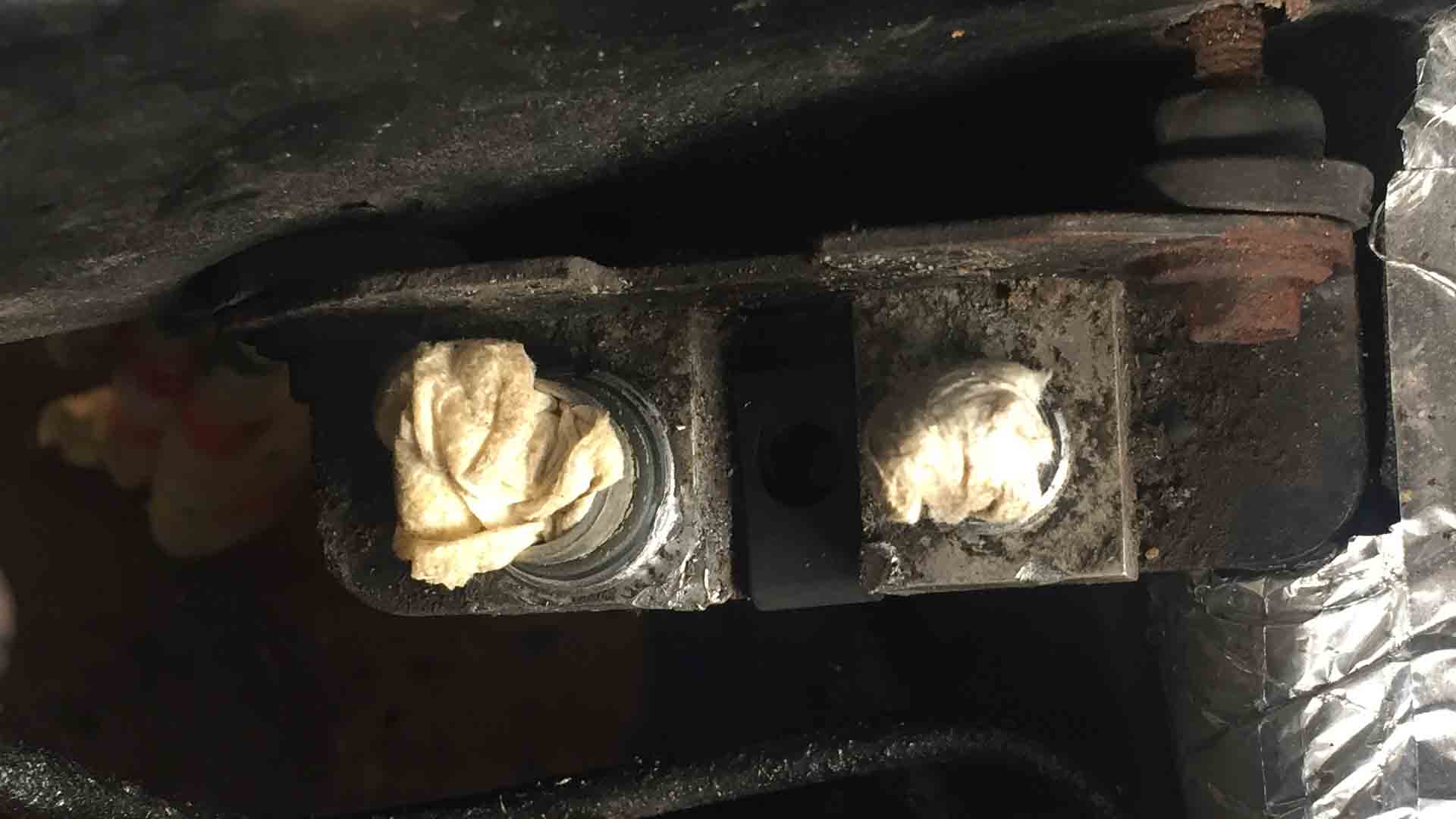

After searching for a replacement 2.8 AC body clip; your local NAPA has the part in stock that will suffice.You only need one for the replacement. I couldn't find any info on the message board so I thought I share it here.
BALKAMP 665-1997 (M6 1.0 Screw Size)
Fits perfectly and the new bolt I sourced works with the clip with no issues.
Hope this helps anyone who cant find a replacement

Can you post a pic of this please? Trying to understand...

No problem buddy. Better with pictures! Center clip between the AC Connections.

Oh, it's like a speed clip, but with a nutsert for a bolt instead of just tangs for a screw.

So true! NAPA knew what it was when i brought the broken piece to the store.
