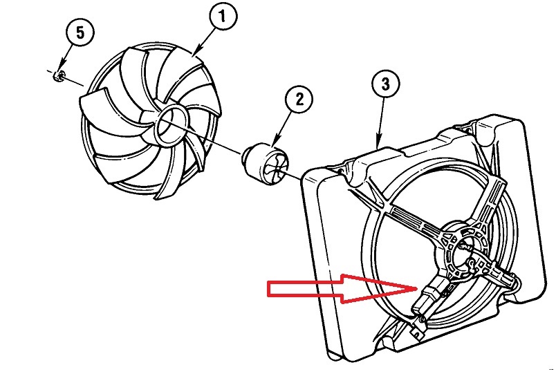

'84 Fieros with Air Conditioning got the 2 speed fan. Cars with a 2 speed fan have a large ceramic resistor on the fan shroud.

Only the 84's had the 2-speed radiator cooling fan.
You will need the switch with the pigtail in your case. Splice it into the Lt Green/Black wire that controls the High Speed fan circuit. Leave the Low Speed Dk Green/White wire disconnected. The A/C control will still run the Low Speed circuit as normal if you have A/C.
