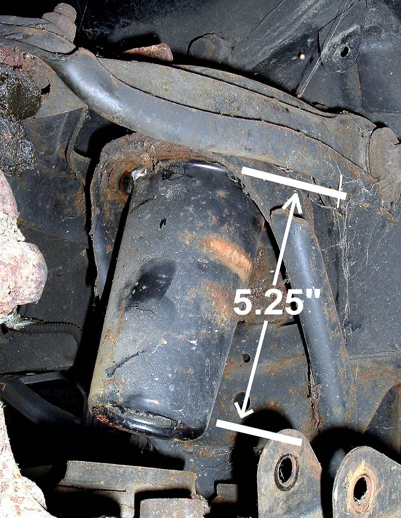

| quote | Originally posted by Patrick in This thread:
I cut off two complete coils from both the front and back springs of my '84. The back was fine, but the front was definitely sitting on the bump stops. Made for a rough ride! I got some assistance from Fiero club friends of mine (with welding equipment) to cut and weld the metal cones. I had read that removing 3/4" was ideal, as removing more could possibly lead to the shocks bottoming out. Not a good thing!
Pictured below is a cone on my parts car to show how long it is before being shortened. The rubber bumper was removed prior to this picture, but on my '84 the rubber bumper was reinstalled after the cone had been welded back on. The metal cones are now 4.5" long.
