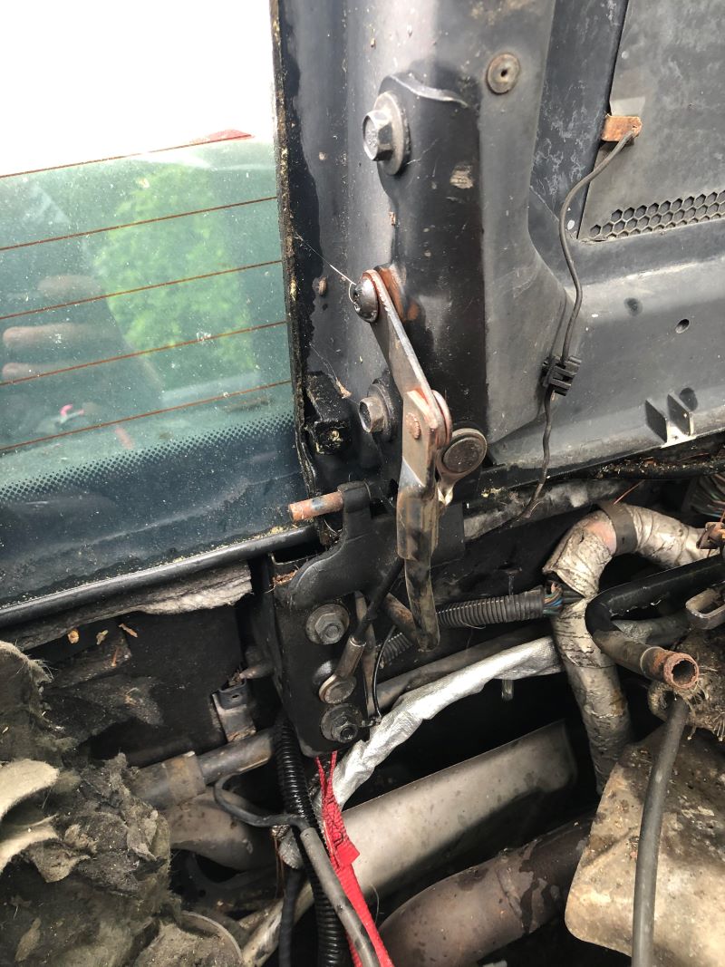

My issue is the deck lid opens too far as in pushing against the rear window far. I spent some time comparing it to my ‘88 Formula decklid that functions correctly and they looked identical and I don’t see any parts missing.

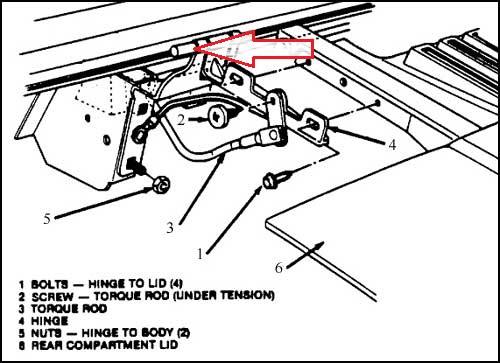

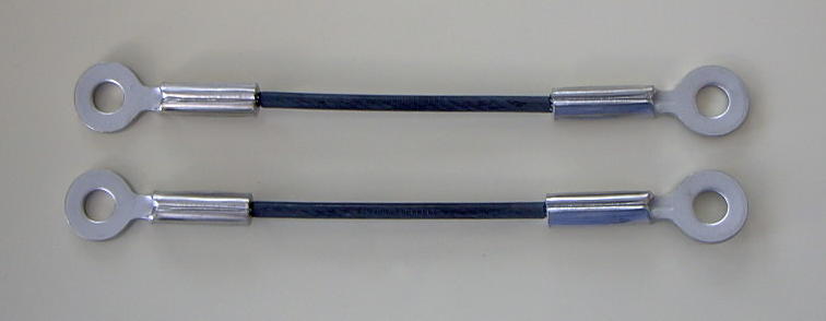

Your decklid straps are gone or broken. They are steel cables on each hinge that keep the decklid from opening too far.
If they're missing, it's a pain in the ass to replace them. The hinges need to come off and the rivets need to be drilled out. http://rodneydickman.com/pr....php?products_id=110[This message has been edited by IMSA GT (edited 05-28-2020).]

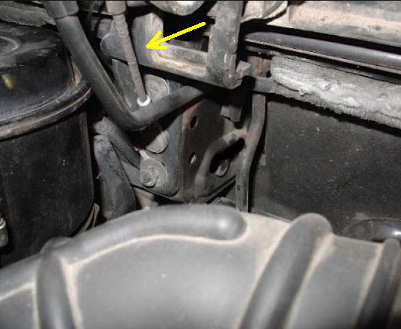

LOL, I wonder how many of us are taking the same picture right now ...
Anyway, another option it seems would be to replace both hinges?

I like your picture better. I stole mine from the internet

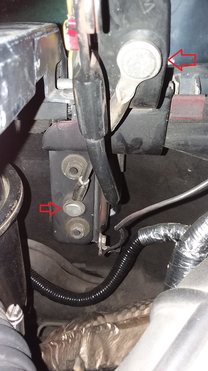

Yep I checked those, they are both still on the car and the same length as the Formula's (I was assuming maybe someone put longer ones on that is why I checked length)

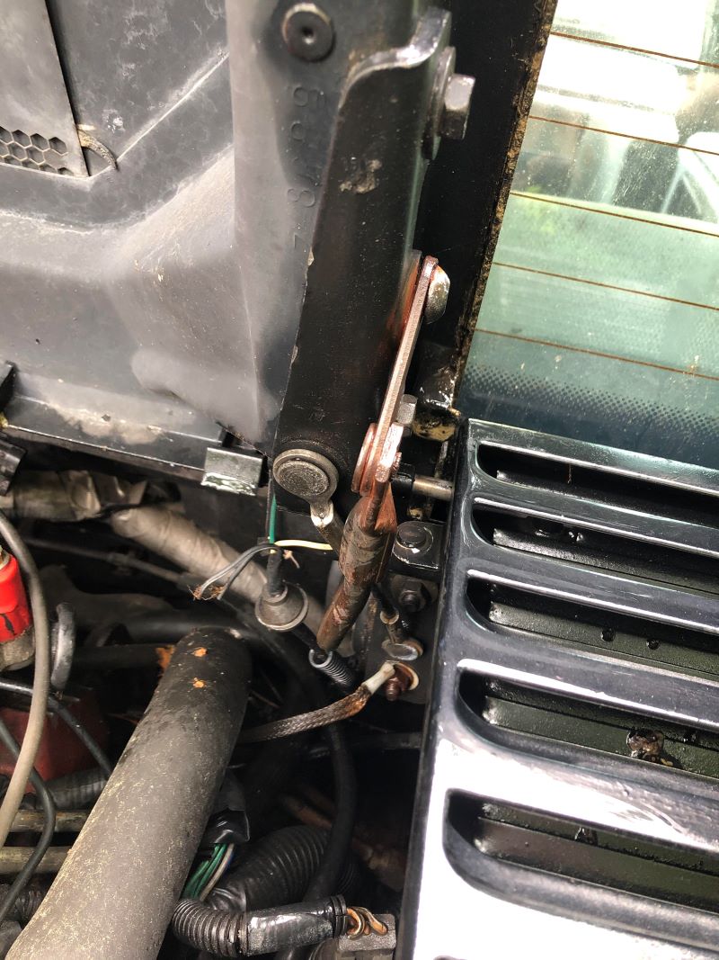

Pictures may help, I see nothing out of ordinary:

Could the hinge pin be broken? They can shear and be hard to see.
