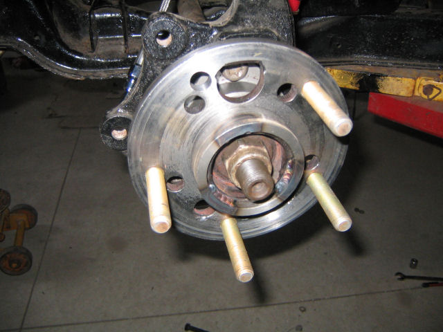

The rears require more than just re-drilling. A ring has to be welded on to inscrease the diameter and the hub has to be increased from 57.1 mm to 70.3mm. This is not trivial, but it's not impossible either. Can't find anyone to do what I have pictured.

Held/Arraut were making a modified rear hub drilled to any bolt pattern for around $600 but they went out of business a few years ago. If I remember correctly they were getting the hubs direct from the factory disassembled then welding the larger flange on and putting them back together. Permanently. So everytime your bearings went bad you would have to get the procedure done all over again. I was going to go that route then ended up having to use adapter/spacers for my widebody in the rear which I'm ok with because I needed an extra inch or so. Ended up being much cheaper In the long run as fiero rear hubs are cheap and easy to get. The front wheels are already wide enough so I just have to redrill the hubs. To make someone's job easier I was going to buy a cheap $30 Vette Camaro rotor to use as a drill guide and a hubcentric ring to center it. Don't trust myself or my ancient tool collection enough to try it.
