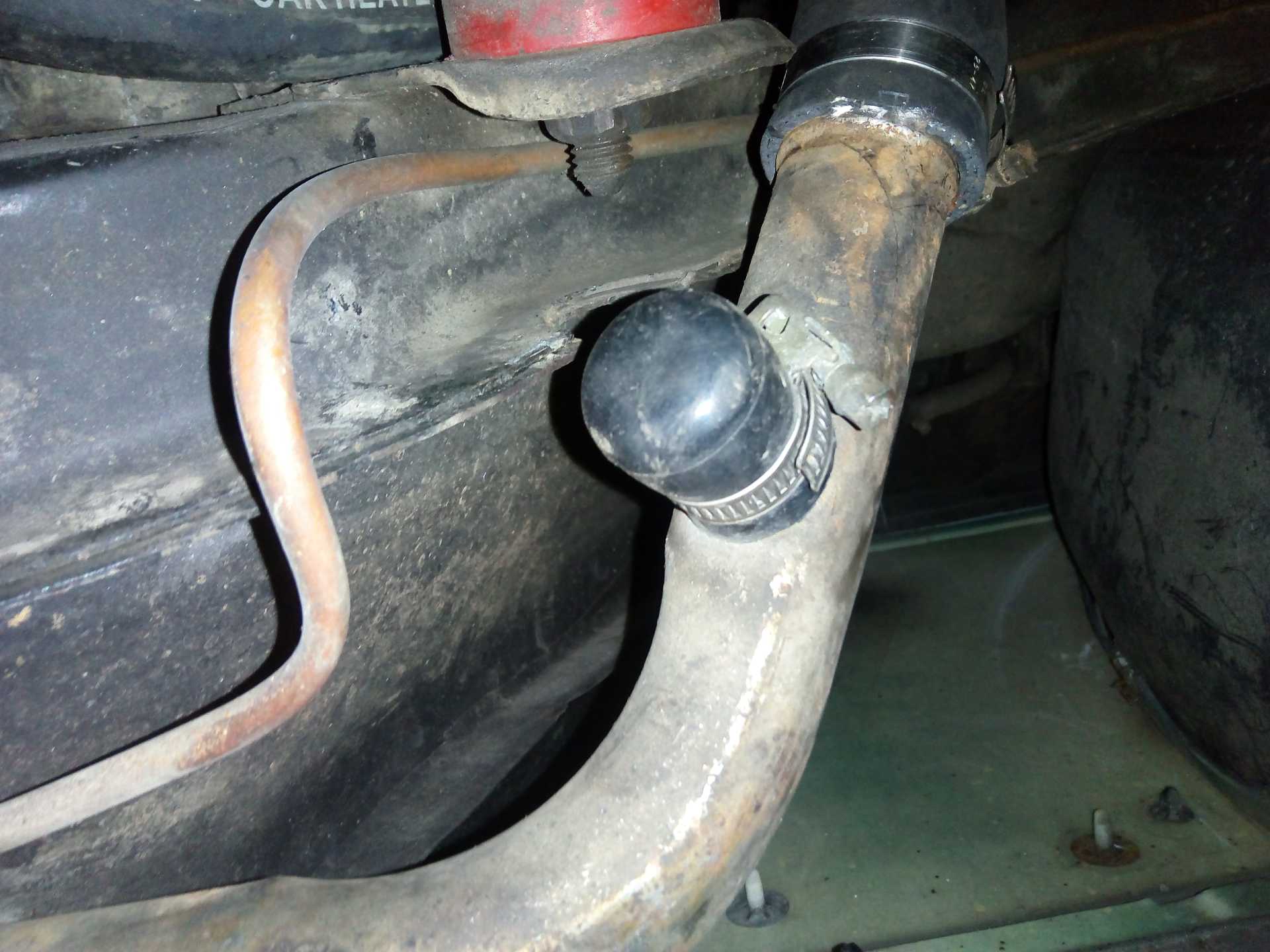

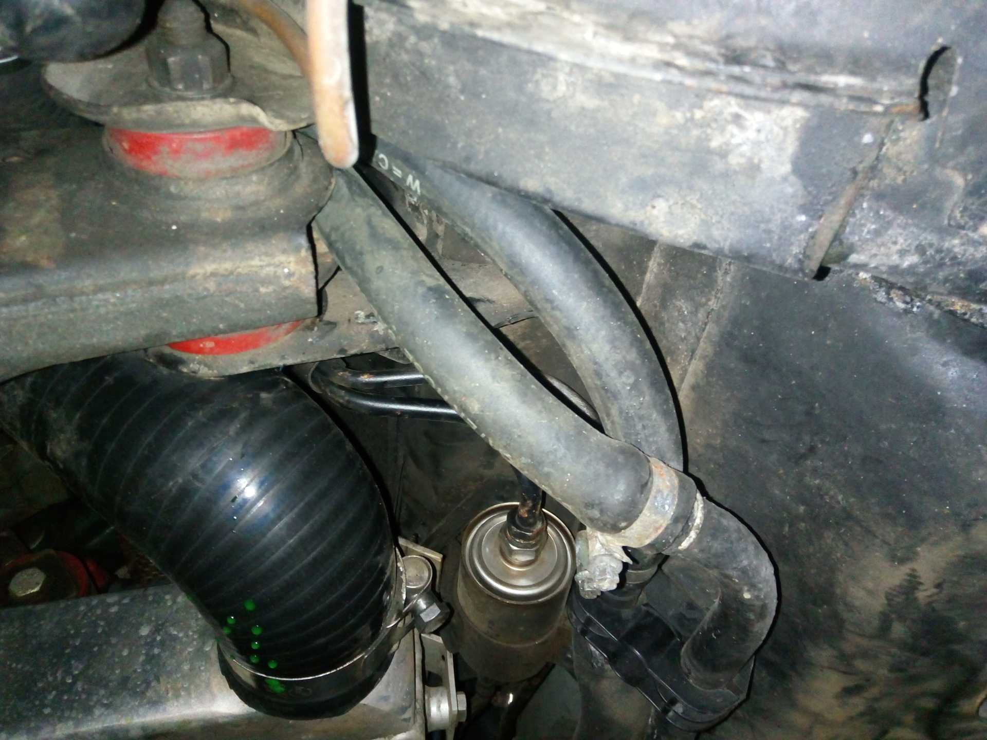

Frenchrafe JUN 14, 02:44 AM
Thanks Dennis, yes I have flushed the radiator using garden hose fittings and pipe deblocker solution! (We call it "Destop" in France - it's pretty corrosive and cleans really well!)
So I'm just wondering if my heater hose routing and turbo cooling is not taking all the (easy) flow for the cooling system?
Leaving the engine block with very little coolant flow?
As has been pointed out previously, this is not the first time I've had overheating issues!
Do cars fitted with 3800 engines have restrictors or valves for the heater circuit?
As I explained in my build thread, this engine was hard to come by in Europe and I didn't have the donor car to check this kind of thing.
Maybe I've always had bad flow because the heater circuit takes priority and nearly nothing is pushed through the block?
When I routed the hoses, I capped the heater return on the right hand side rigid front to rear pipe. This was because there is a return inlet on the 3800. So I just used this.
I'm thinking maybe I just made a rather effective engine coolant bypass circuit by mistake !?
Pics of cap and heater return reroute:
Pic of 3800 heater outlet and return, as on my engine:
It doesn't involve a big mod to cap the return inlet on the engine and reroute a short length of heater hose from the rigid heater return pipe back to the original position.
I may well try fitting a restrictor in the heater pipe outlet at the engine as well.
Stay tuned…
Rafe
P.S. I know there are drops of coolant in the photos, I'd just refilled the system and managed to splash everywhere!
