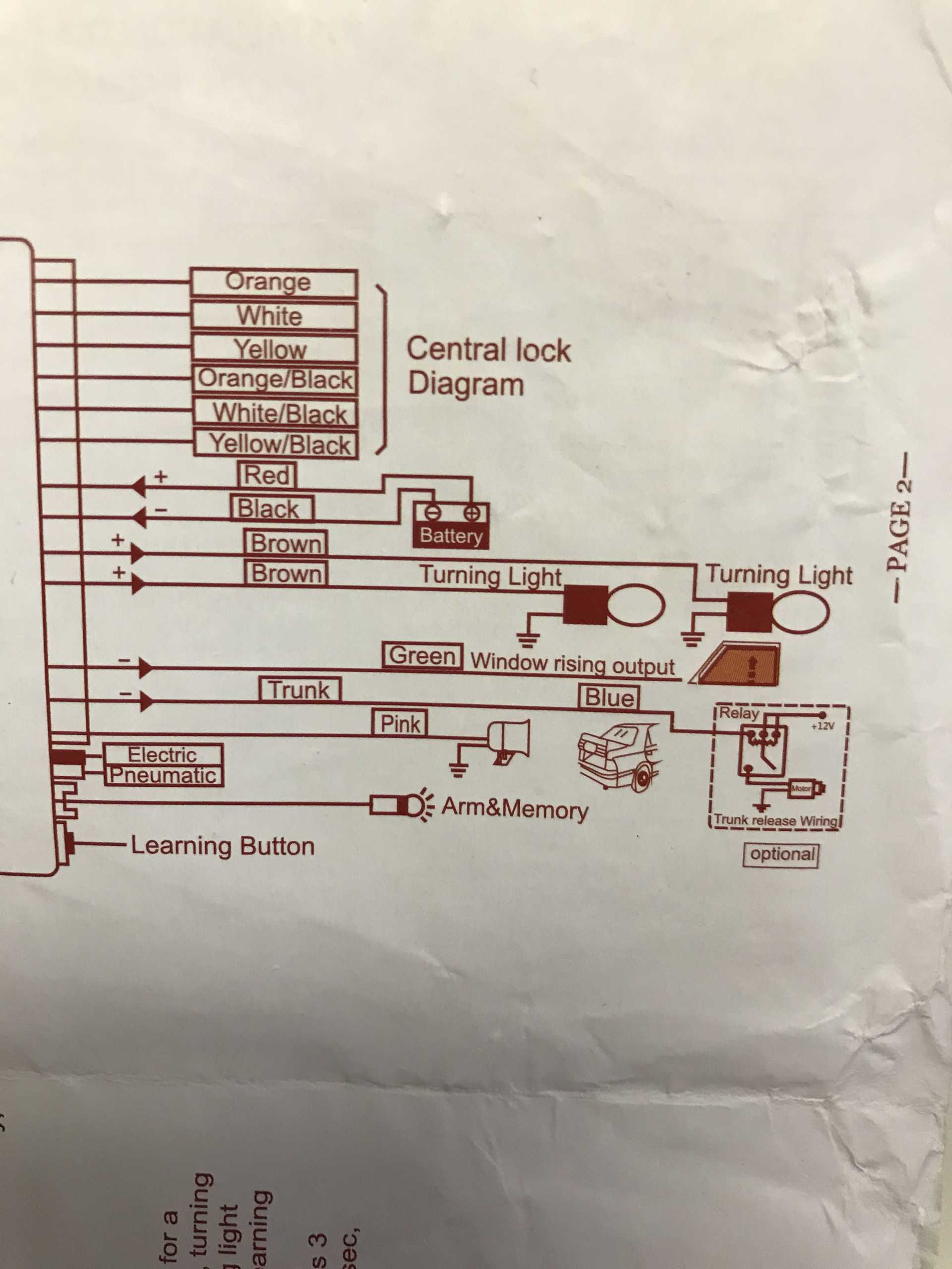

I installed a keyless system on a friend's Fiero (and will be doing the same to mine in the future). The doors were not a problem, but the rear trunk latch was another thing, and I have yet to get that working. I did a bunch of searching on this site but could never quite get a clear answer on what exactly I needed to do. I understand I must to install a relay, can someone explain (diagram) exactly how I do that (and were I tap into the factory wiring)?

So, the one I got from Amazon is the same as the one above, just dug out the lousy instructions. I don't have a diagram other than what came with the unit, but as I said above the trigger for the trunk release on this unit is negative, and the Fiero trunk release relay gets a positive signal from the trunk release switch. The wire you want to tap a positive output signal from the new relay into is a gray/black wire from the trunk release switch to the trunk release relay under the dash. In the diagram below, the blue wire from the unit goes to the negative side of the relay coil; the positive side of the coil and the relay common tie to your power source (always hot, likely the same source you used already for your keyless entry control). The normally open output of the relay then ties into the gray/black wire mentioned above. Unfortunately I didn't take any pictures of the trunk release wiring, but relay is pretty easy to find under the dash. Hope this helps.
