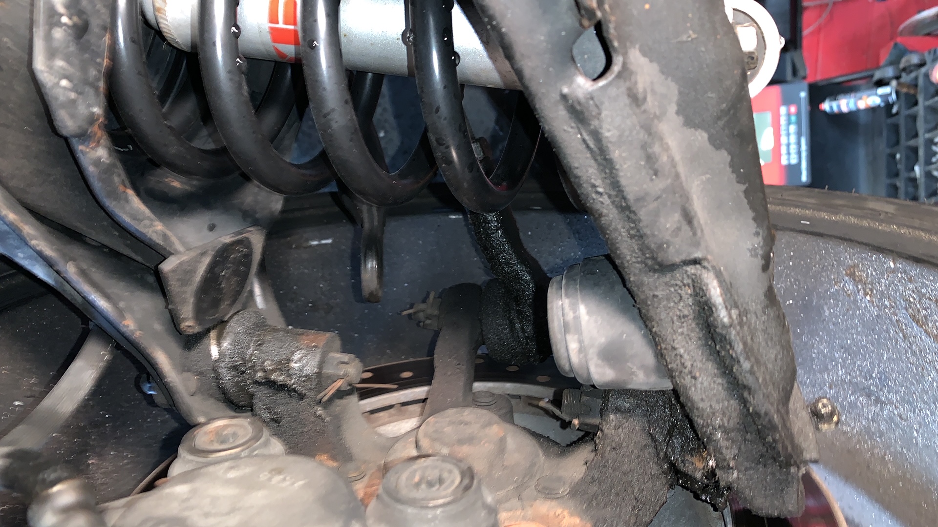

Hello
Can anyone tell me why this is happening? 88 GT, stock suspension except for TFS drop springs.
When the car is on a hoist, the bump stop pad on the upper control arm touches and pulls off the upper ball joint boot (both sides of the car)
Any suggestions as to what causes this?

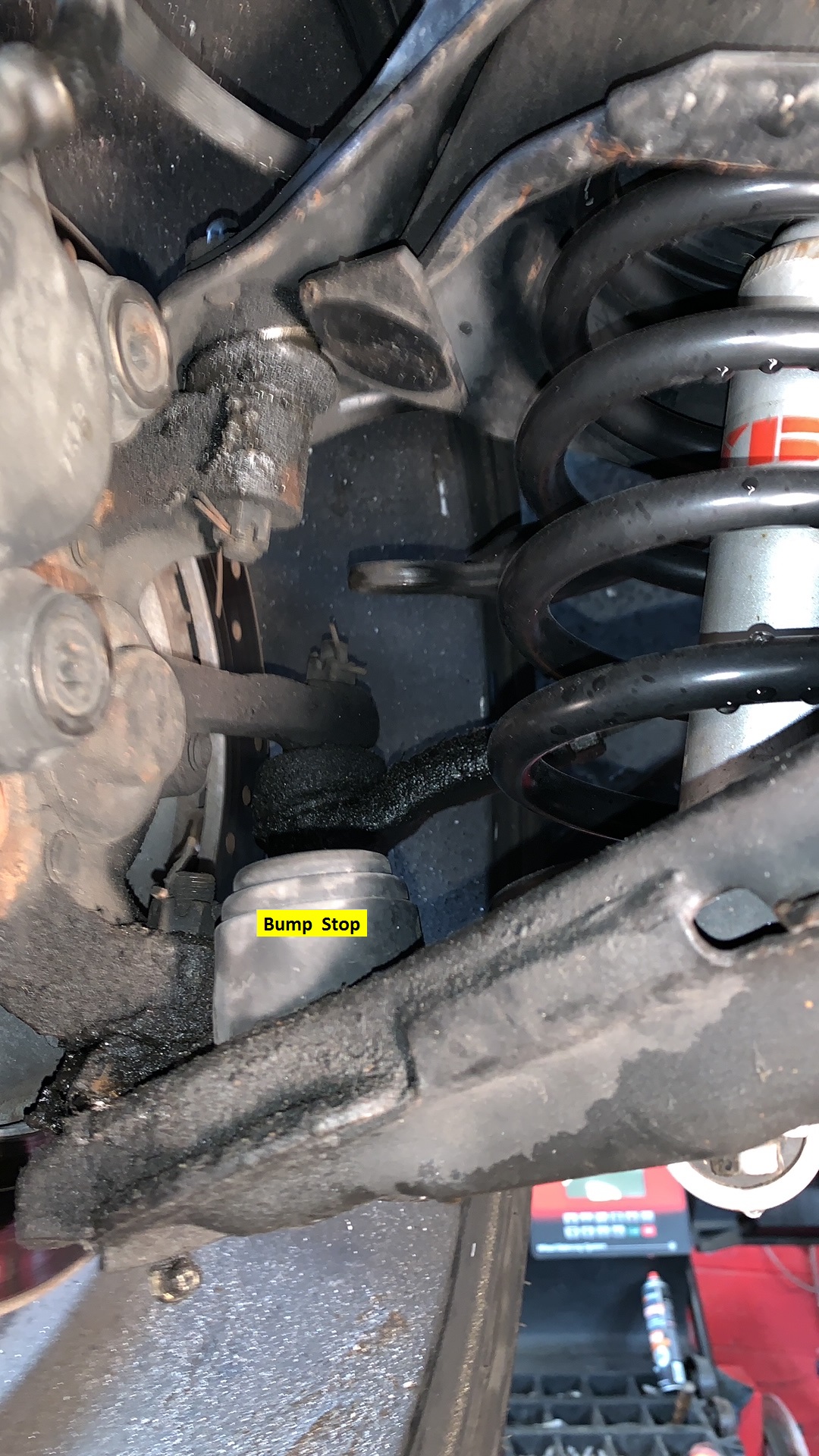

cam-a-lot
MAY 20, 06:55 AM
Thanks, but how would any of those 3 possibilities allow the control arm to touch the boot? It is interfering quite a bit. Even if I put on a brand new balljoint and put the correct amount of grease in it, it will rub from the looks of things...
Not sure why the picture loaded sideways, sorry.[This message has been edited by cam-a-lot (edited 05-20-2020).]

fieroguru
MAY 20, 08:55 AM
Now that I see the pic... the issue is the KYB shocks. They are longer than stock and allow the suspension to droop down further. The longer length also make them more prone to bottom out internally on lowered cars. I always recommend installing spacers between the lower t-bar and the lower a-arm.
From the picture, you are constantly riding on the (non-stock) bump stops as well.

cvxjet
MAY 20, 12:27 PM
I believe it may be your after-market bump stop; 1988 Fiero bump stops are wedge shaped, while yours appears to be a round shape. You may be able to cut away a small portion on the offending side......

cam-a-lot
MAY 20, 07:12 PM
Thanks everyone
Sway bar link is missing for some reason- just noticed it and ordered a new set
I don't think the car rides on the bump stops anymore. It used to when the PO installed springs that were cut far too much and there was no suspension travel.
Good info on the KYB shocks- may try to play with them or replace them to see if the issue is resolved. Bump stops were from TFS- I don't think they are the issue since I recently replaced the front springs to the TFS drop springs, and now I have a lot more suspension travel.
