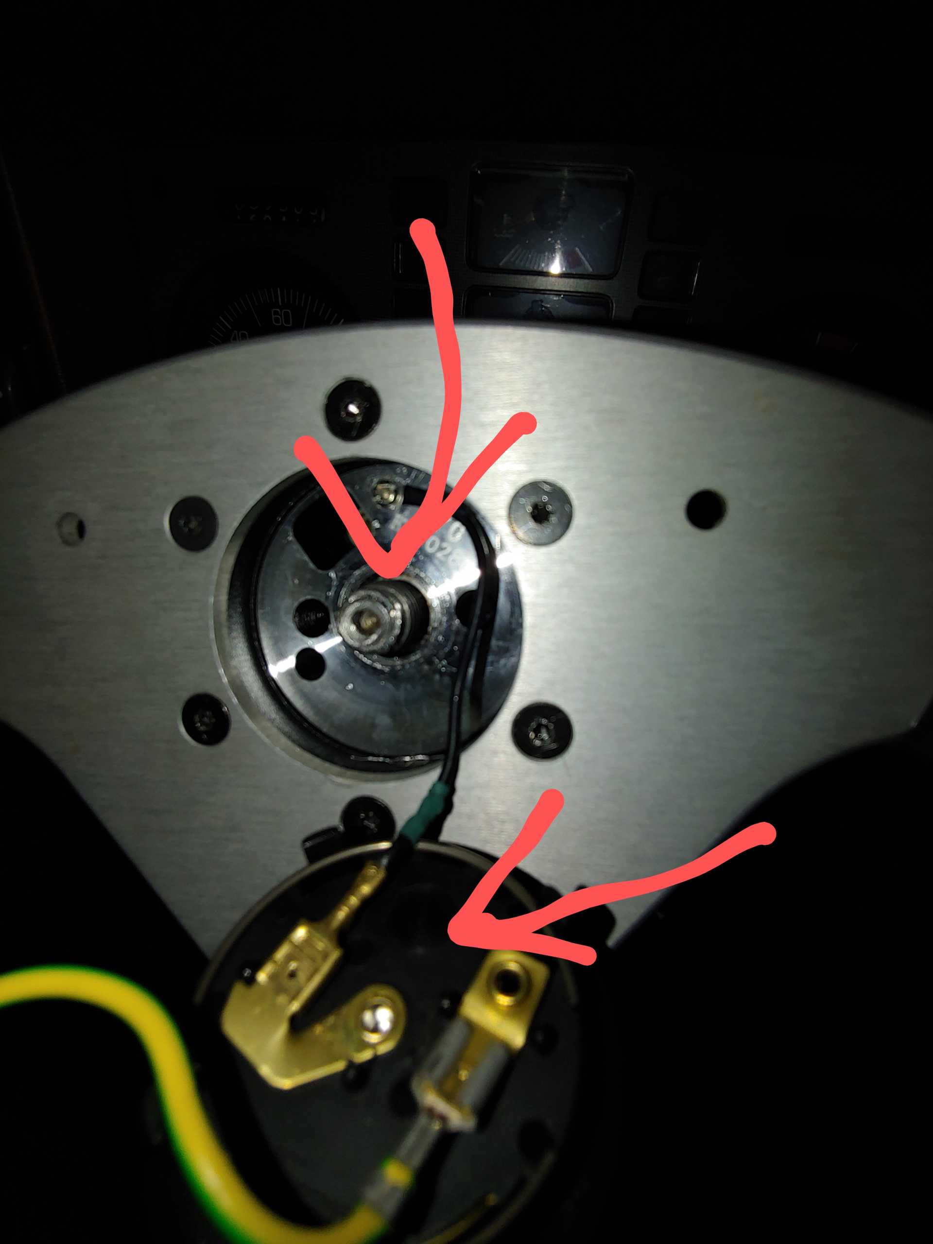

Hey Patrick, I actually did try what you mentioned and tried using the stock Fiero hub, but I ran into the same issue. I think it has to do with the horn button itself, it is completely flat on the back side with no recess to accommodate the end of the column shaft.

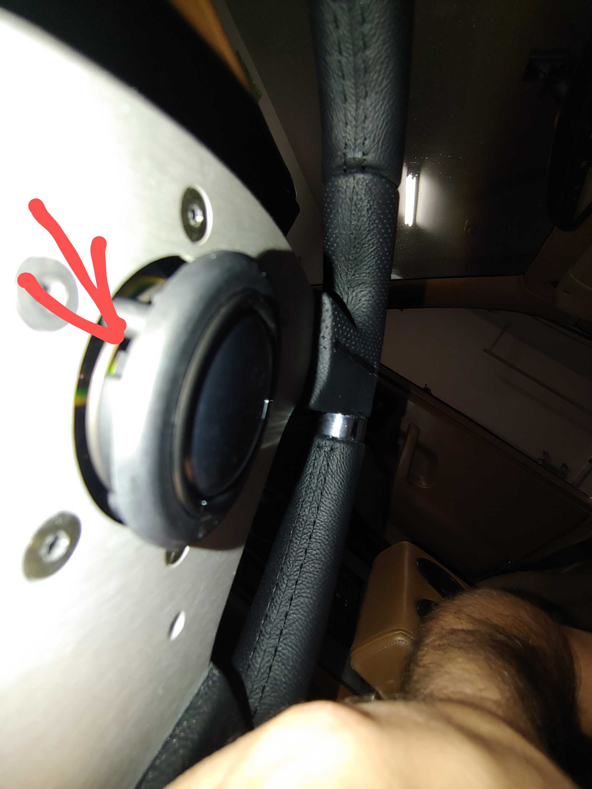

Here you can see how far the horn button sticks out.

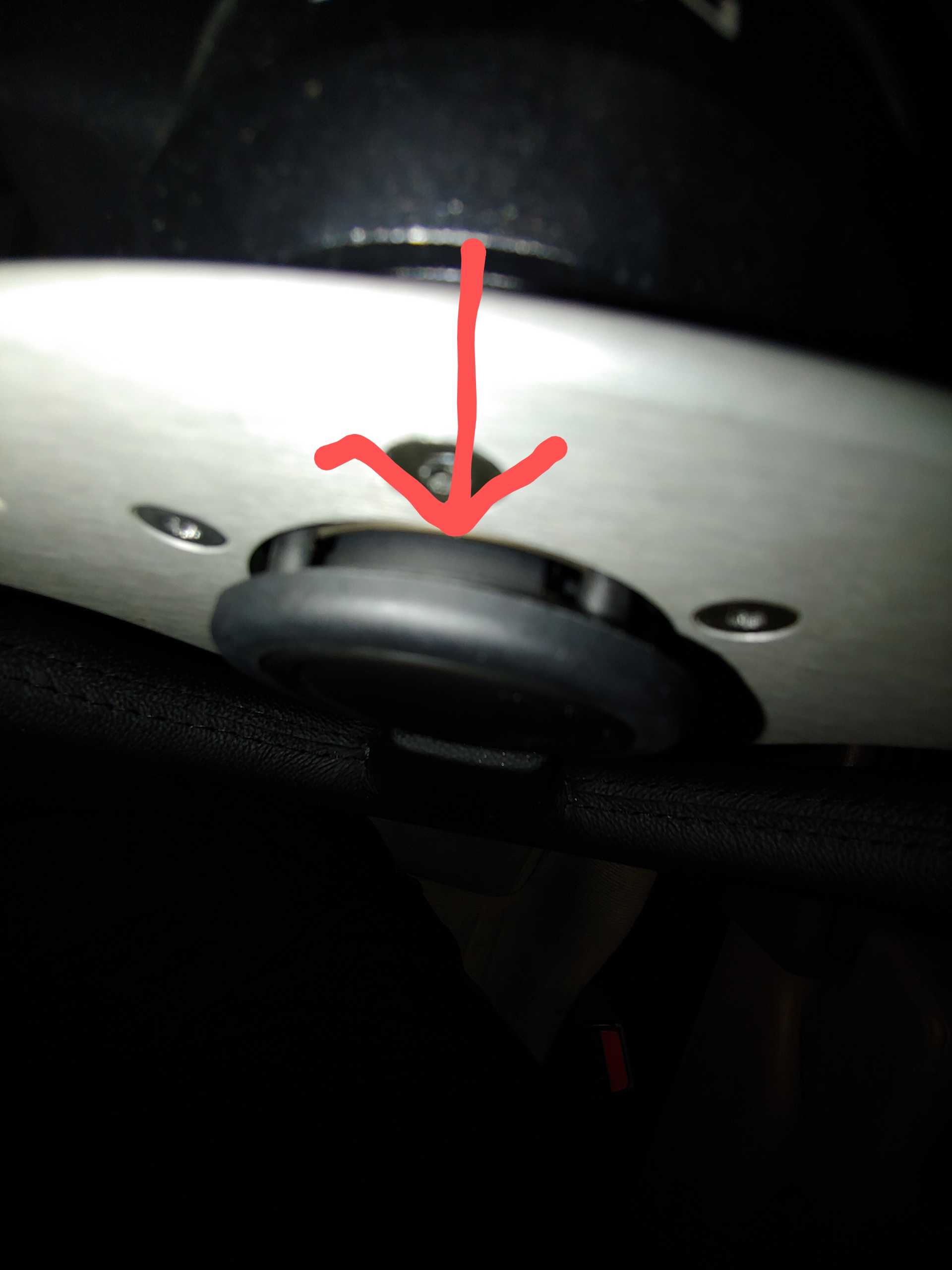

And here is the shaft and the back of the horn button.
All that I can think of is to use some sort of spacer on the shaft, or trim it down.
