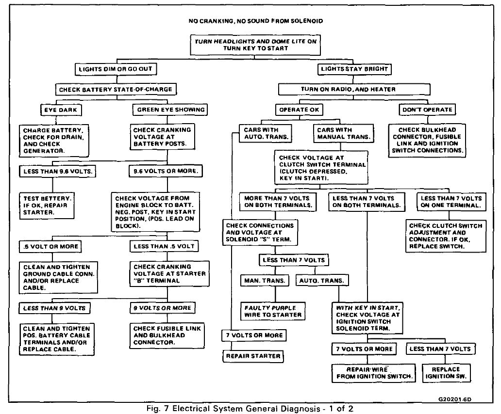

Put up the headlights then try to start. Do the lights dim??? If not then you can be pretty sure the starter solinoid is not engaging. Check to see if you have voltage there when attempting to restart.

If the car starts fine and then loses power after 15 seconds, a likely reason would be heat at the starter fusable links. If that is true, a large portion of the electrical system should not be working, along with the starter. [This message has been edited by Gall757 (edited 05-17-2020).]

Looks like I'll need to check the wiring at the starter. That has been problematic before. Thanks Gents...
