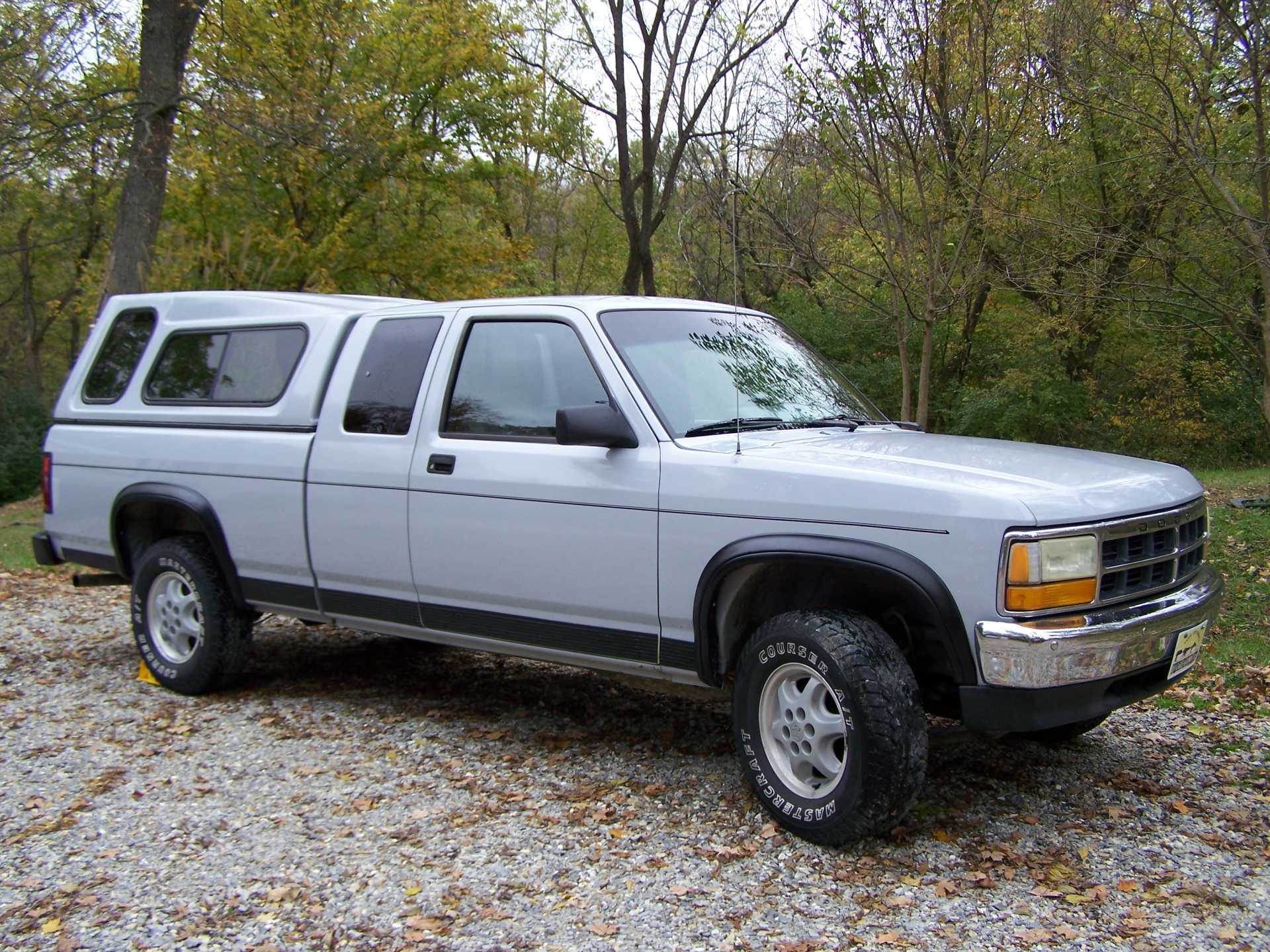

Agreed, lot less work. I painted this Dodge Dakota with an HF gun and single stage acrylic from TPS Global Restoration Shop.

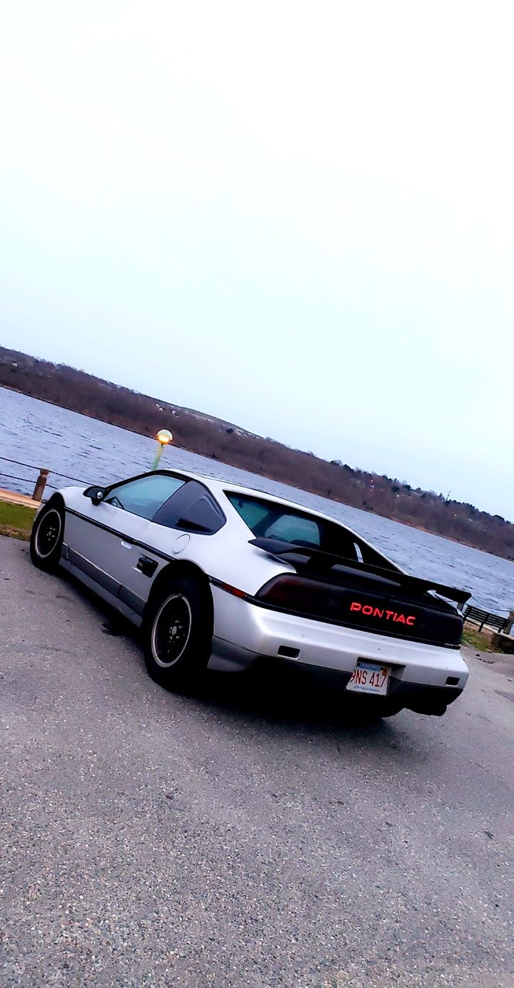

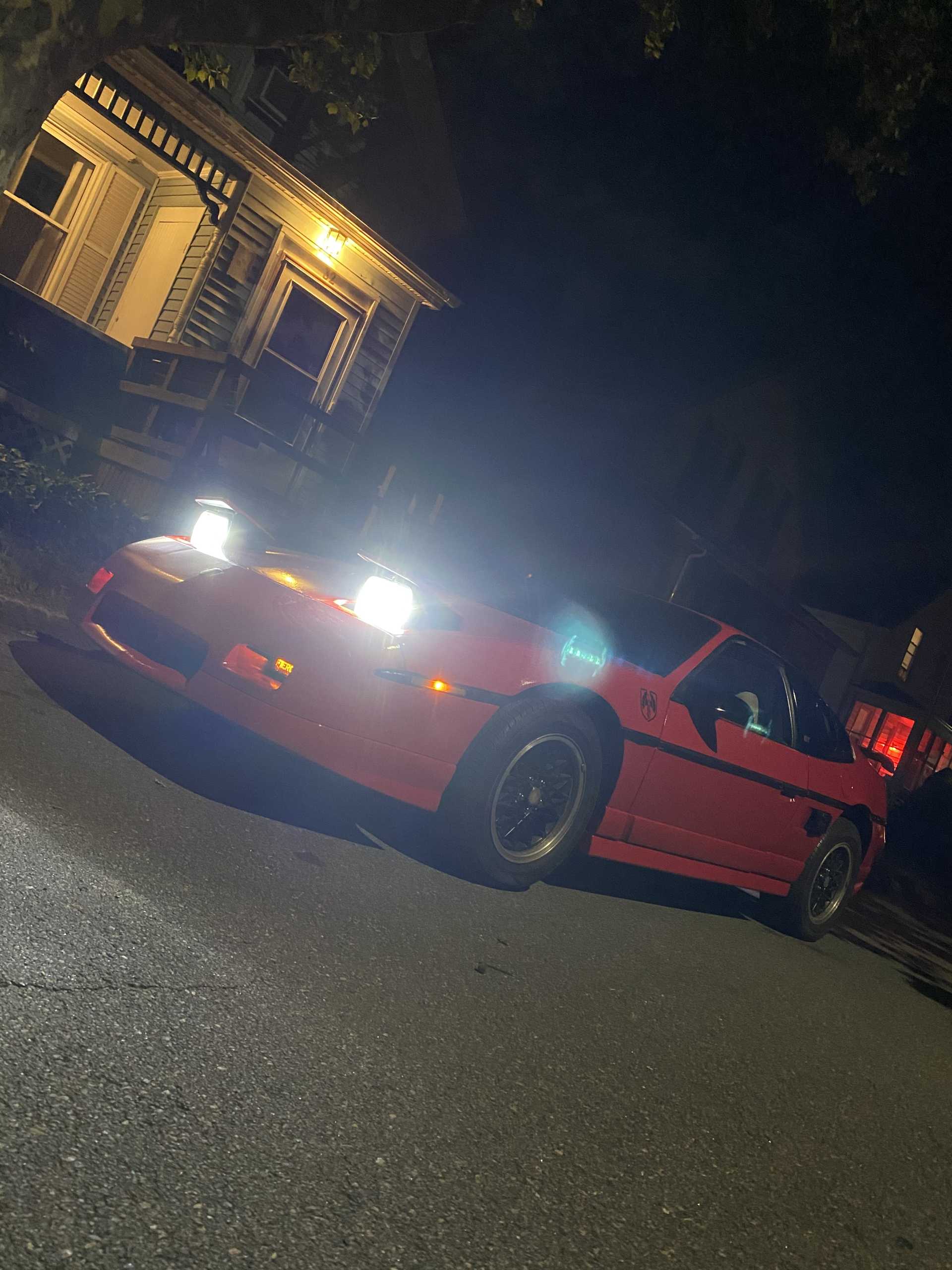

After
Before
Well here is the outcome 2 coats of primer, 4 coats of M.F red and 1 coat of clear. Haven’t buffed or wet sanded the clear coat but I’m happy with it a lot better then before that’s for sure
shemdogg JUN 02, 10:56 AM
Didja roll or spray it? Put up some closer pics in the light, looks good from the pic
