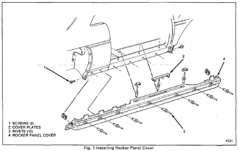

Does anyone know the size of the rivets for the rocker panel cover ? I had to replace mine today since it has been cracked for so long found a decent one at the bone yard that I installed but need rivets to finish
fierosound MAY 17, 03:32 AM
Sizes not shown in P22 Parts Book. I am guessing they were 1/4"x 1/2" long - maybe someone can verify.
But the 3 top ones were aluminum, and the ones along the bottom were plastic rivets when I took these off.
