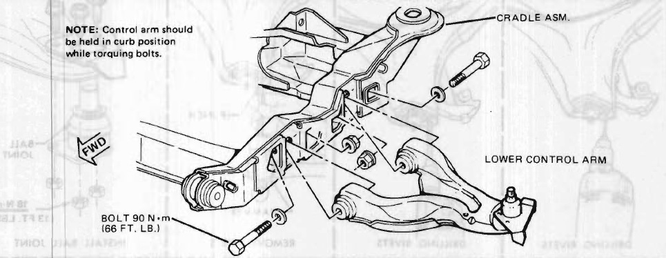

Did you torque the rear control arms bolts properly to 66 ft-lbs?
There is such as thing as too tight which would prevent the suspension from responding quickly.
Put a jack or stand under the control arm to support the weight of car before tightening.
It's important to have torqued all bolts properly on all the front components for proper suspension response as well.
