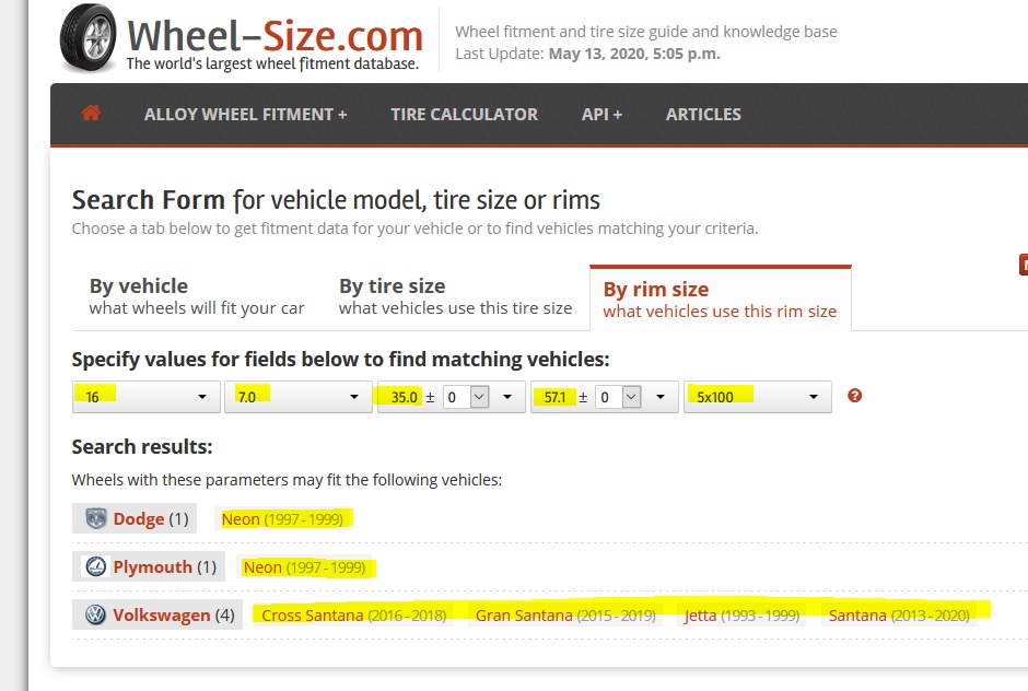

Here's a good website that can tell you which wheels might work on your car - Wheel Size Dot Com . I put the numbers for my 88 Formula in and it spit out the following wheels from other cars that might fit mine:
Also I remember back in the day there were a few guys using 16" rims from about a 1990 Chevy Beretta GTU.
-Rick
