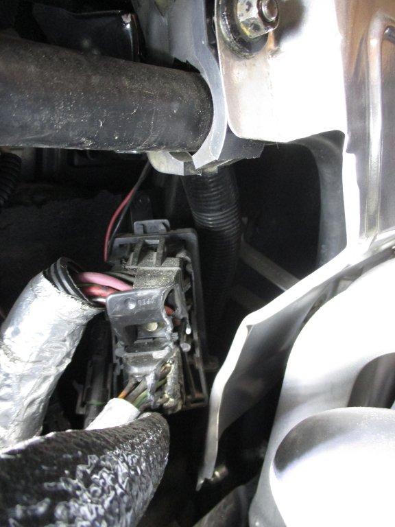

84 Fiero has fusible links at the starter. Check those.
http://www.fiero.nl/forum/A...110502-2-104117.html
Also the C500 connector is on the firewall.
Even with the heat shield, exhaust heat can melt them.
