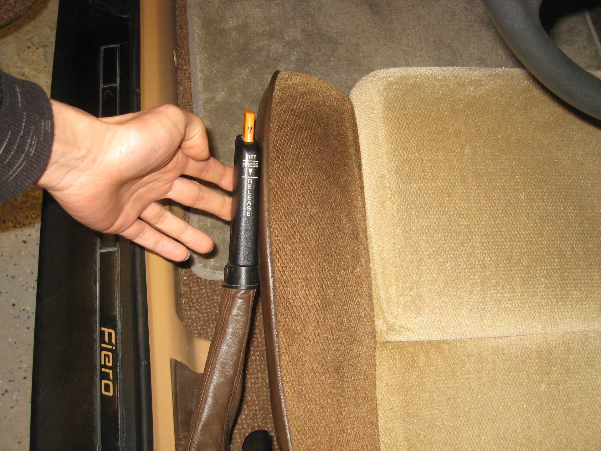

| quote | Originally posted by sjmaye: One thing that always bothered me is that my e-brake handle really rubs the side of the seat base when I try to use it. So badly It is virtually impossible to use.
Both of my 1985 Fieros have been like this.
I thought it was just a Fiero quirk.
Edit to add photo:
I just pulled hard on the lever to bend it a bit away from the seat.
The lever seems to be not very strong and easily bent. It is possible that this lack of strength is what allowed the lever to get bent crooked in the first place. It may be worth taking it off the car to inspect for broken welds and stuff like that.[This message has been edited by pmbrunelle (edited 05-08-2020).]

I had thought about bending it a tad. You encourage me!

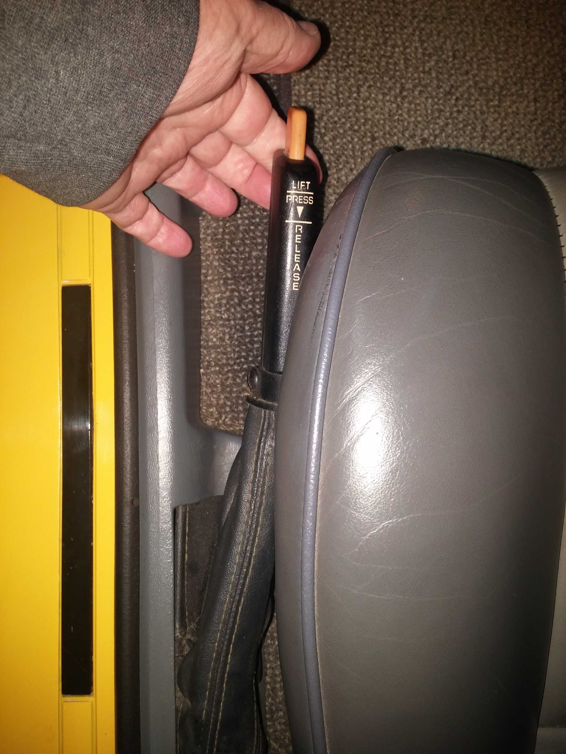

MAY 08, 03:03 PM
Looks like brake handle is bent. They aren't very strong in side-to-side movement. Just went out a took a pic of the handle in my Indy.
