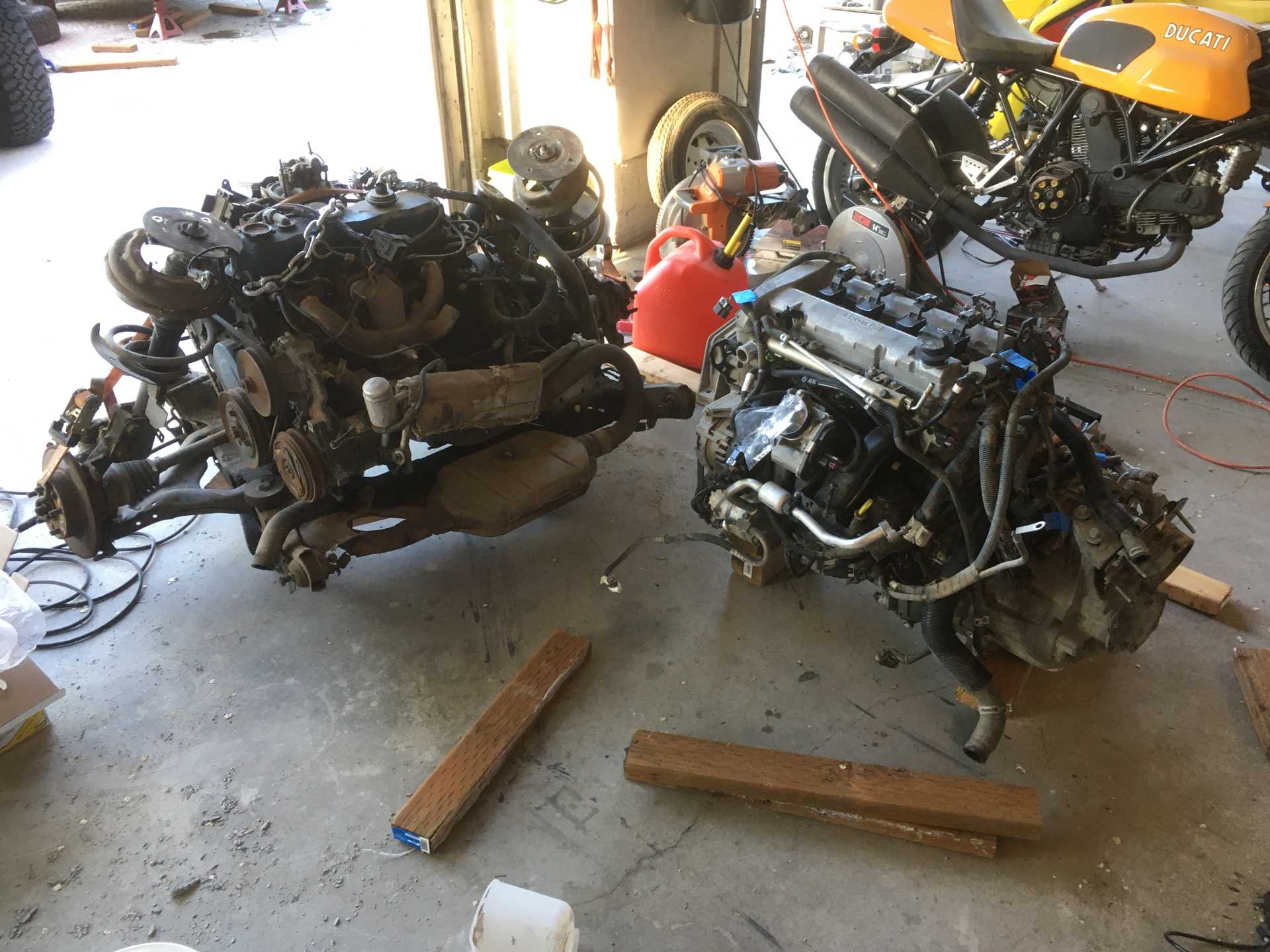

So the engine in the Cobalt (did that a couple weeks ago) and the engine/cradle in the Fiero are out. Did that last night. It was kind of a ***** , only because the legs on my engine hoist were competing for space with my roller dolly I was trying to drop the cradle onto. I think I'll make some sort of cradle dolly when it goes back in.
Obligatory me standing in the engine bay shot:
Duke in cradle, Ecotec on blocks

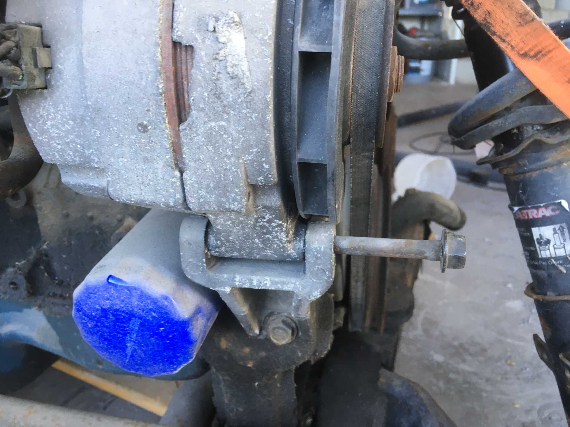

Apparently the PO might not have torqued the alternator bolt on the duke! That might have been exciting at some point...
