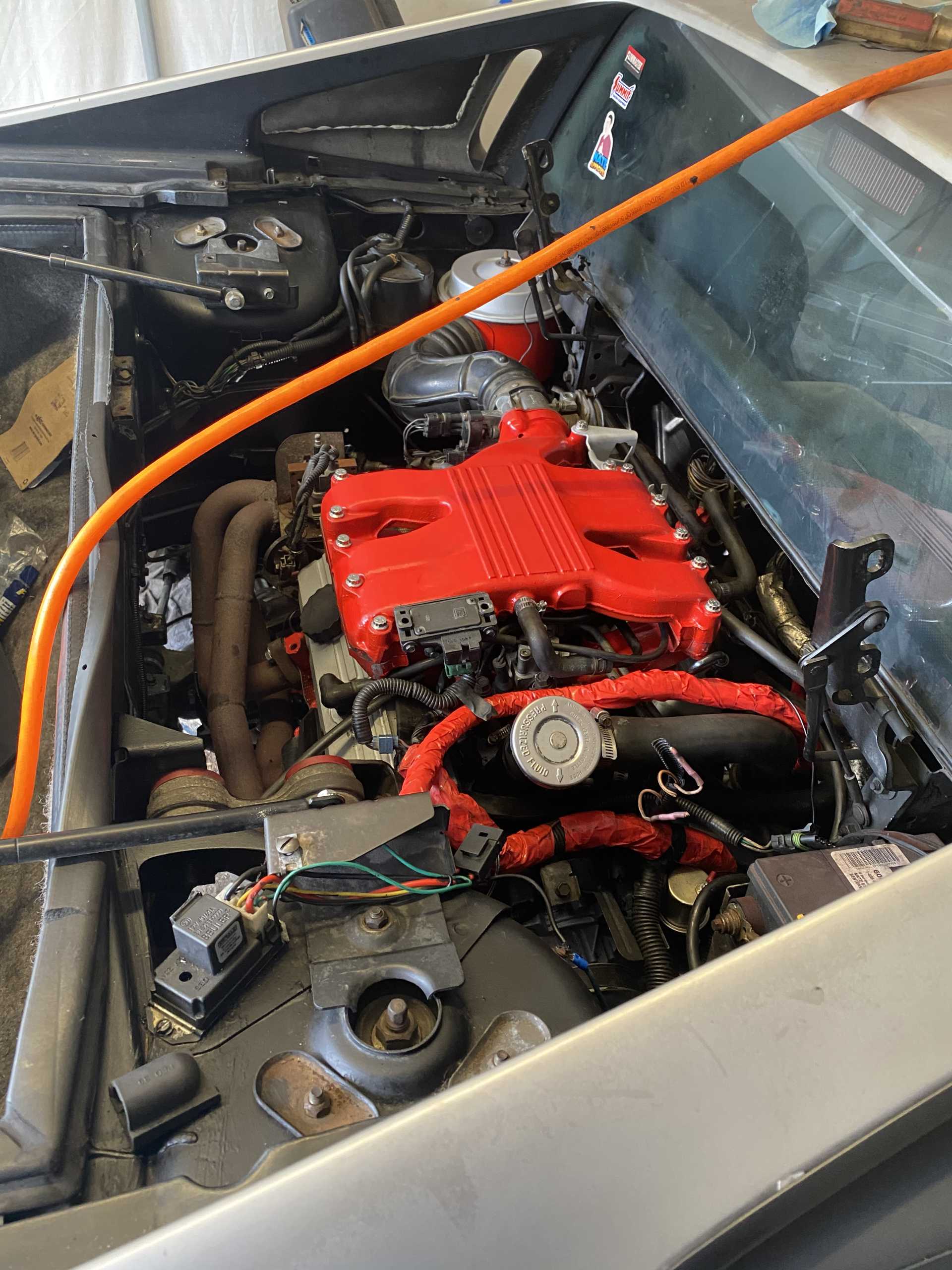

Ok so just finishing up low miles 2.8 install and at the dreaded timing point. Now did the whole finger in no.1 hole passenger side of block. Brought it up to 0 apparently tdc put distributor in pointing at no.1. I then did the whole a and b thing at the ALDL port. Can hear Iac clicking making noise ses light flashing. I then try to start it and getting back fire 🤬 as I’m cranking where did I mess up. Now I know you are all gonna say it’s 180 out but how is that possible. Wouldn’t I not feel anything if I was on the exhaust stroke doing the finger in no.1 cyl hole. ???? Confusing as hell. I just want this damn thing running since I’m running out of time and need to be back to work on Monday

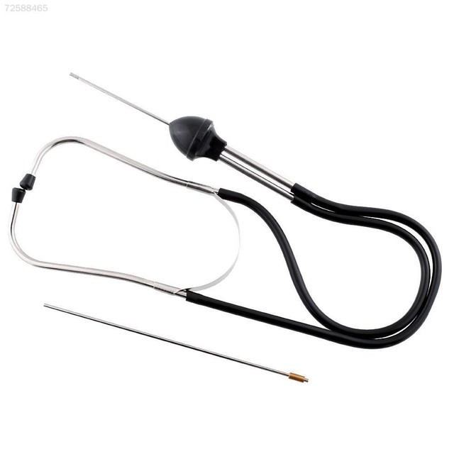

Don't panic yet. Get ones of these Mechanic's Stethoscopes and listen around.
