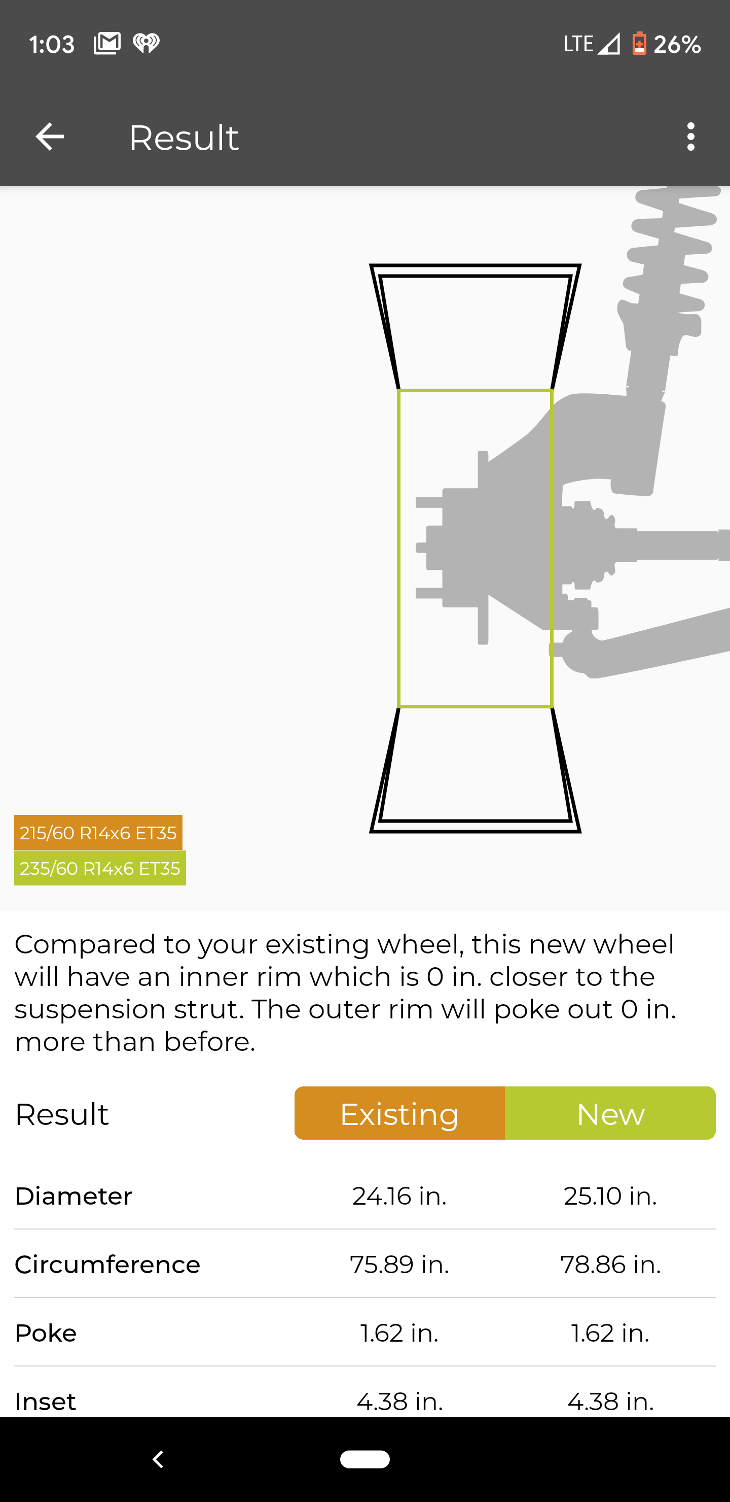

Just realized the ones I linked above require a tube, which adds quite a bit of cost. Now I think I am leaning towards this tire, just not sure if it's too wide to fit the car. Waht do you guys think? https://www.summitracing.com/parts/mnh-mss002
MAY 06, 07:34 PM
Good choice. Better fit on the wheel, still plenty of width, and high wrinkle sidewall design.

You don't think I'll be too wide? I have factory suspension in the rear, if needed I may go coil overs, but I'd rather not for the time being
MAY 07, 01:04 PM
You will have plenty of clearance.
