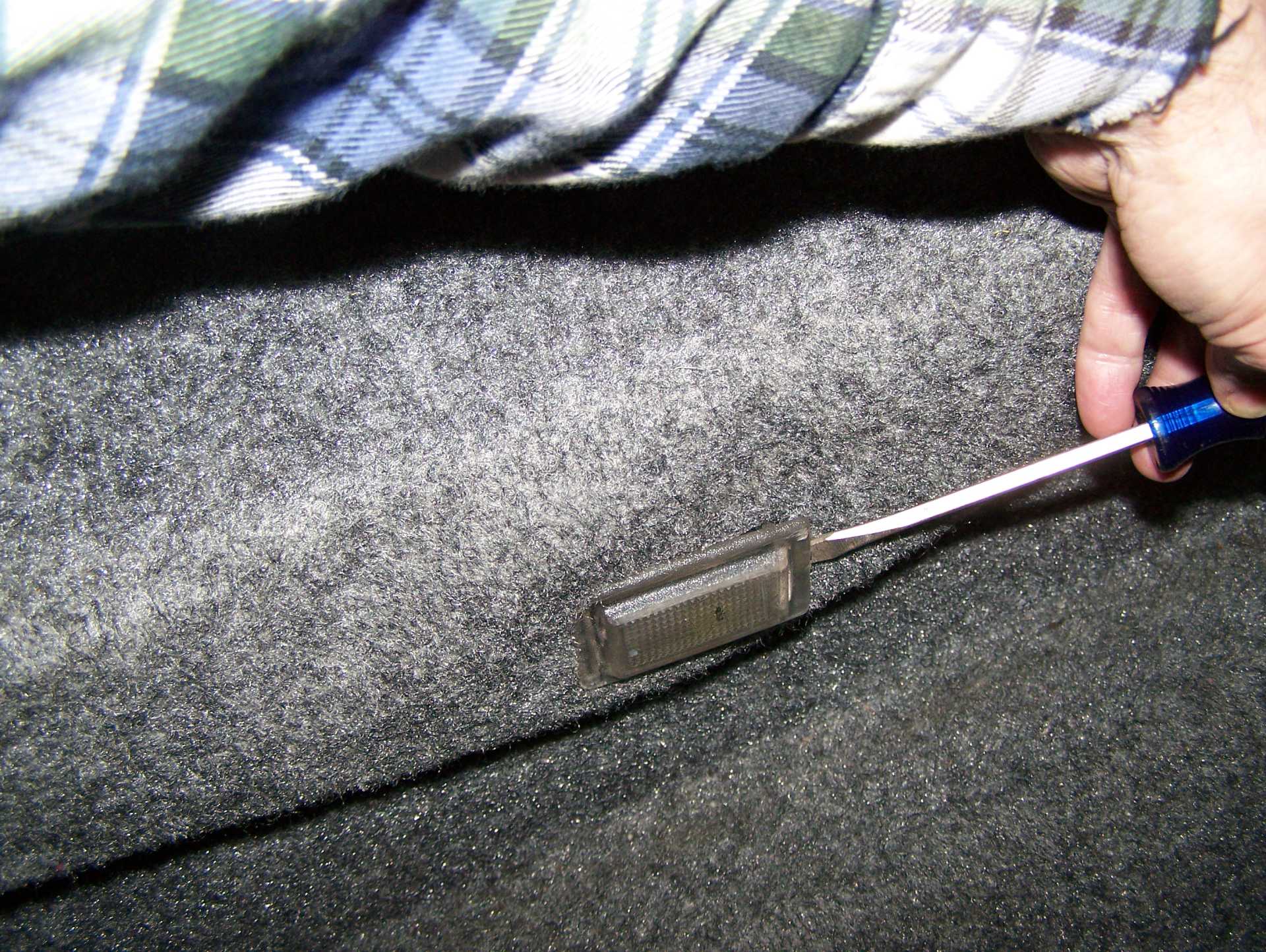

Really stupid question from a really stupid person.
How do you remove the trunk light to replace the bulb? I can't find the answer anywhere, and I can't seem to get it out.
What am I doing wrong?

If I remember correctly the OEM light has some tabs/clips on the back of the lens that hold the assembly in place. They need to be squeezed or gently pressed on one end to get the lens released. I would look at my cars, but all of them have a different bulb assembly to that I could use an on/off switch.

As mentioned, snaps on sides. Gently pop right (passenger) side out (towards rear of car) first, then slide to the right. I think.

I had not messed with this lite in 20 years- I got frustrated with it pointing in my face (Why didn't they position it by the latch so it wasn't shining in your face?)

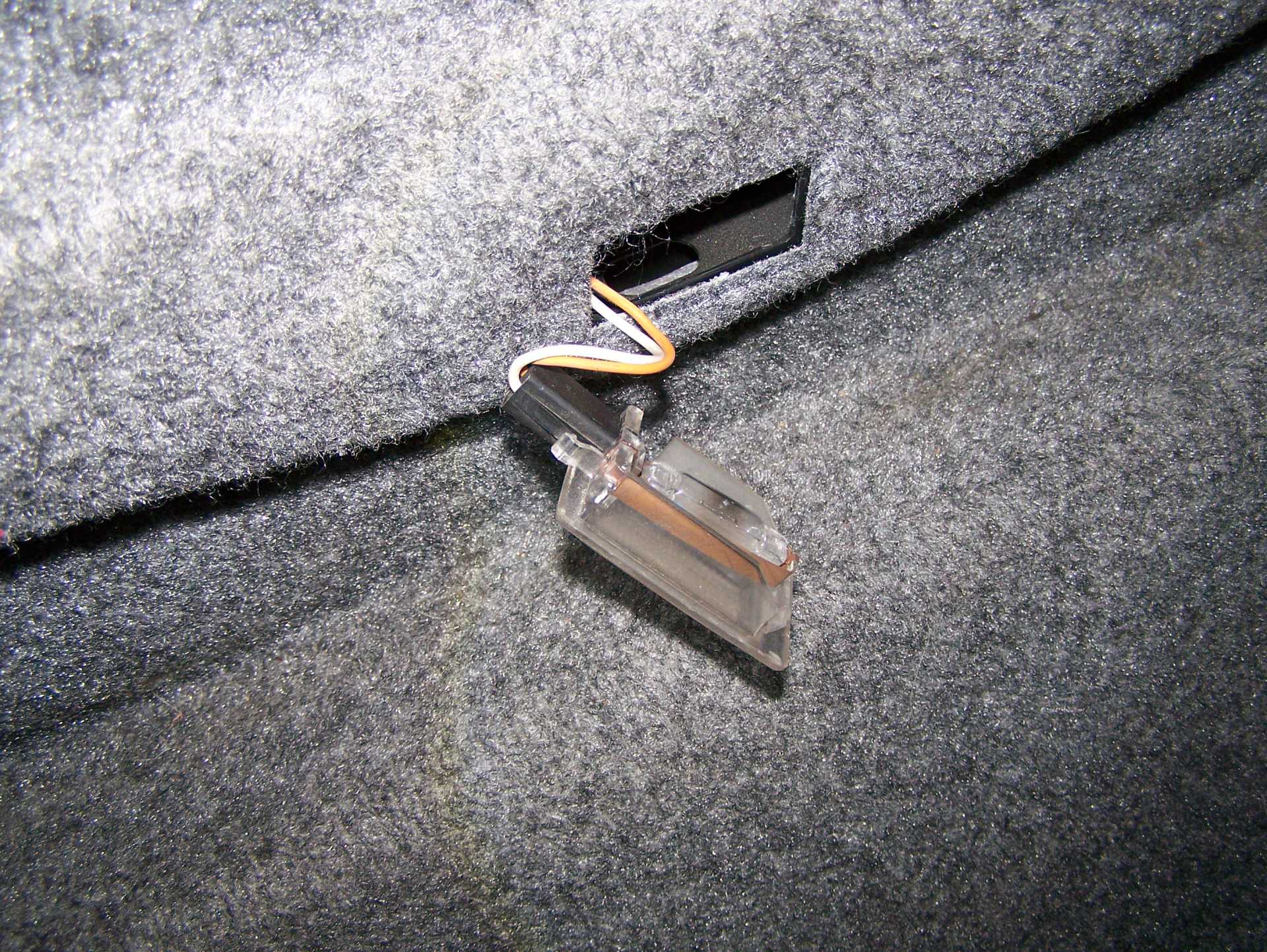

Anyway, I checked in my "Do it yourself" booklet, and it shows to use a screwdriver on the right (Passenger-side) to pop it out; The whole fixture comes out so get the slot screwdriver in deep and carefully pry till it pops loose.

Many thanks!
I had heard that these are easy to break, and I can see why!
Thank you so much for the photos.
Not so Confused in Perry, MI (aka Dave Riedle)

Fieros can be tricky. For instance you must pry the trunk light assembly out from the right end exactly as shown. If you pry from the left you will break it. Sometimes the old brittle 30 yr old plastic chips even when removed correctly. If you do break it the Fiero Store sells new ones that look exactly the same but use thinner copper for the lamp holding tabs. I just reuse the old heavier copper tabs and put them on the new. As for the topic being a moronic question; I do not believe that it is. ------------------ " THE BLACK PARALYZER" -87GT 3800SC Series III engine, custom ZZP /Frozen Boost Intercooler setup, 3.4" Pulley, Northstar TB, LS1 MAF, 3" Spintech/Hedman Exhaust, P-log Manifold, Autolite 104's, MSD wires, Custom CAI, 4T65eHD w. custom axles, Champion Radiator, S10 Brake Booster, HP Tuners VCM Suite. "THE COLUSSUS" 87GT - ALL OUT 3.4L Turbocharged engine, Garrett Hybrid Turbo, MSD ign., modified TH125H " ON THE LOOSE WITHOUT THE JUICE "

When replacing the bulb, be sure to unplug the lens before installing the new bulb and make sure the harness doesn't fall back inside the trunk wall. The bulb gets very hot and very quickly when trying to hook it over the tabs.
