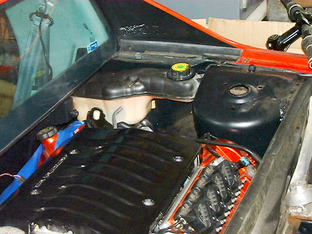

Hey guys,
I installed a Grand Am coolant tank in the back when I did my engine install. Is there any reason to use the front tank off the radiator?

When I did my 2.2 ecotec swap, I put the overflow in the front and used it in place of the Fiero overflow tank. It worked fine, no problems. But it just did not fit in the space very well and there was a lot of extra plumbing that went up to the front of the car to make it work. So I moved it to the back of the car in almost the same spot that the coolant tank in the picture shows. No tank up front anymore, and it still works fine. ------------------ 86 GT built 2.2 ecotec turbo rear SLA suspension QA1 coilovers on tube arms
