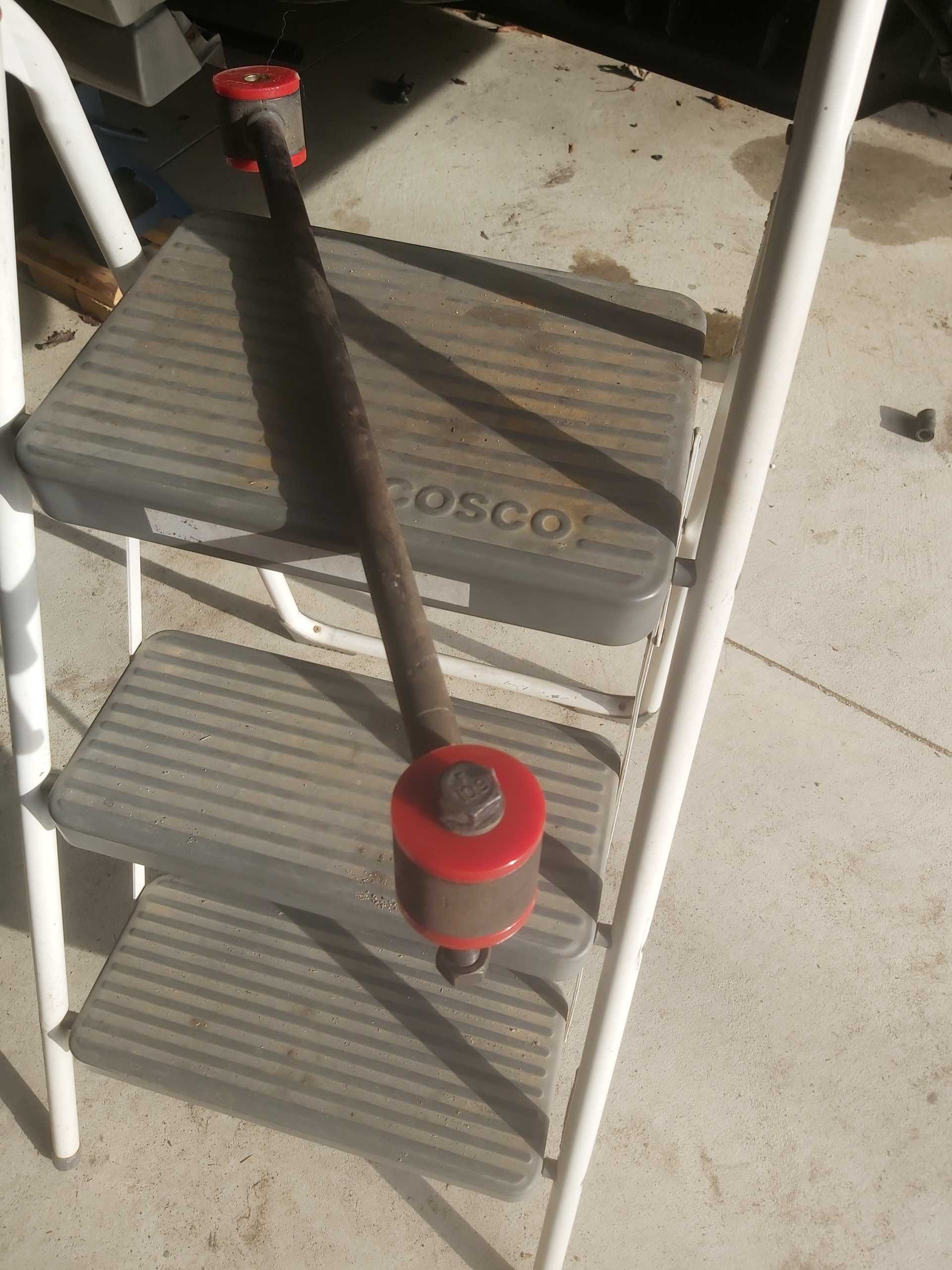

Hello one and all. I am reassembling the rear suspension on my 88 after an engine swap and new poly bushing install. My question is this. If you look at the pic below, it seems to me that there should be a large washer on at least the outside of the bushing to help keep things in place. There was only a small washer on the outside when I took it apart. So is it 1 big washer on the outside? A big washer on both the outside and the inside? Or just a small washer on the outside as it was before disassembly? Also does this apply to both ends of the part in the pic.
Thanks for your help.
DF
MAY 03, 07:03 PM
Big washer between poly and nut

Hi Dave,
One large washer on the outside (between the bolt and bushing), just like Patrick's photo. I'm also replacing the bushings on our Formula currently.
