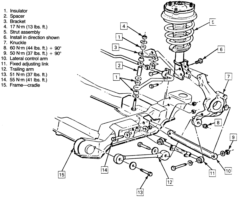

Hello all. I'm beginning to reassemble the rear suspension on my 88 after new poly bushing install. The question I have is this. If you look at he pic below, it seems to me that there should be large washers on the outside to help retain the bushings? Is it a washer on either side, a washer on the outside only or no washers at all? And does this apply at both ends of piece in the pic?
Thanks for any input
DF
MAY 03, 06:50 PM
I see many washers in this diagram.

Oh crap! Another double post. I can't seem to get the hang of the new mobile Pennocks. Except for the posting pictures part. I love that. Anyway, thanks Patrick. The diagram is very helpful.
