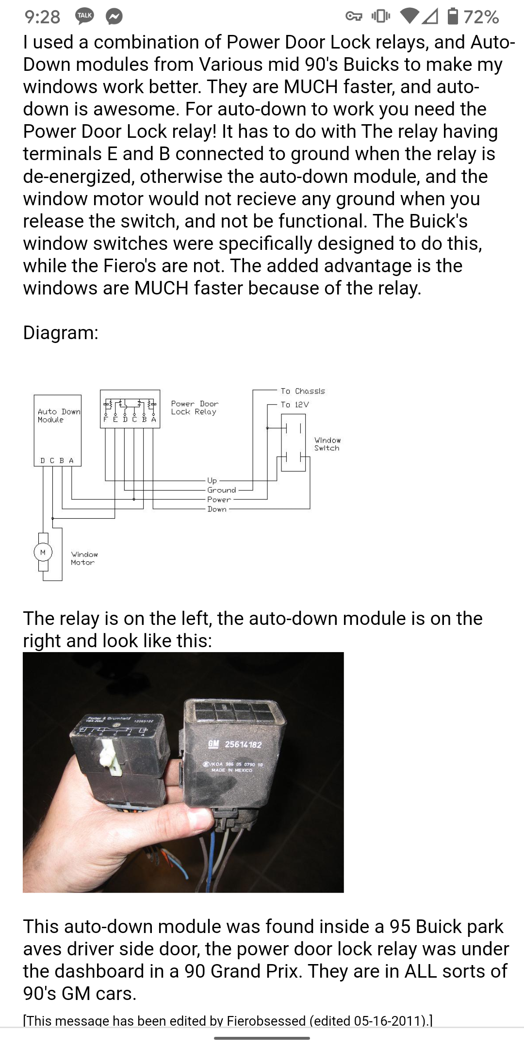

I'm in the process adding one touch down to my car. I tried to install a Firebird module via The Ogre's cave. Didn't work.
Then I found this
And I grabbed the required relays and Buick modules. I wired it up exactly like he said and I am having a short somewhere. My window will not roll up or down. I cannot comprehend what the issue could be. I see a ton of people have done this in the past but there is next to nothing explaining what exactly to do. Any help would be great.
rbell2915
MAY 03, 09:09 PM
I tried it again using the Grand Prix switch and the F-body one touch down module and it worked great. My GP switch has slightly different wiring colors so it was a little confusing. Issue has been resolved and the one touch down module works great. Hopefully it'll be finished tomorrow.

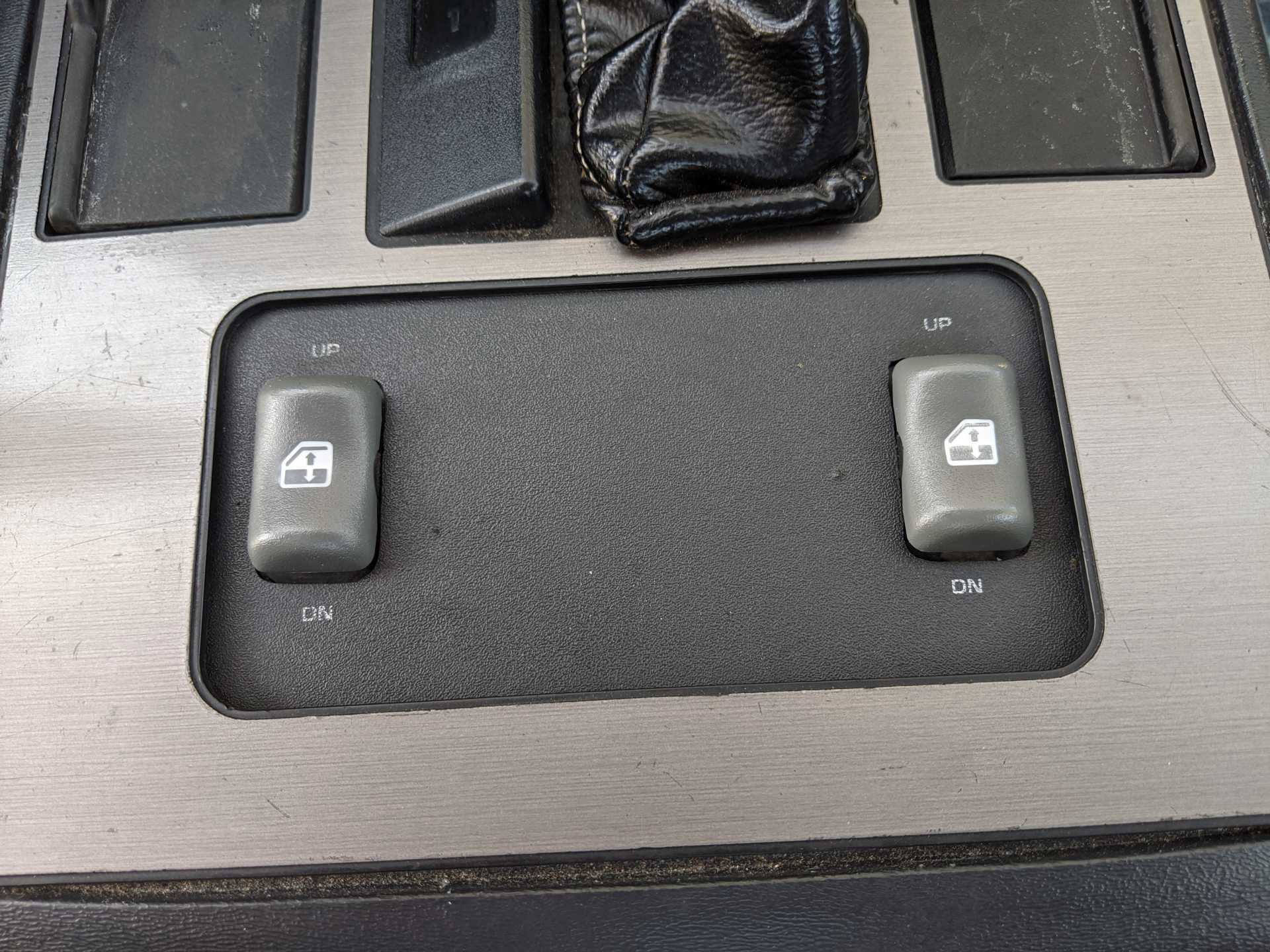

rbell2915
MAY 04, 06:51 PM
Here is a photo of the finished project. Express down works great. I don't think the switches light up though, but I'm happy enough the way it is.
