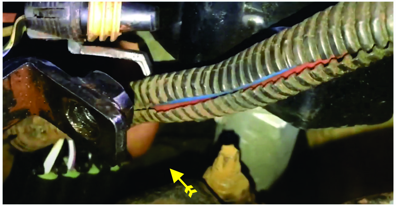

Best I can find on You Tube...
Begin with the #1 piston at top dead center on the compression stroke. Position your distributor and rotor to match up to the #1 plug wire. If you look under the glove box under the carpet there is a single wire with a disconnect in it; locate the tan wire with black stripe under the dash on the passenger side it should be taped to the harness unplug the inline connector and esc will be disabled for setting the timing. If you do not unplug this wire it will never time correctly. With this wire unplugged time is just like a normal vehicle. Just remember to turn the engine off re-plug the wire and then let it idle for a few minutes. Turn the engine off, restart it and then you should be good to go. Cranking it and letting it idle gives the computer time to reset itself.

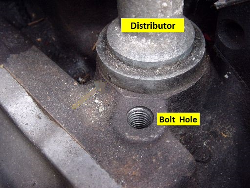

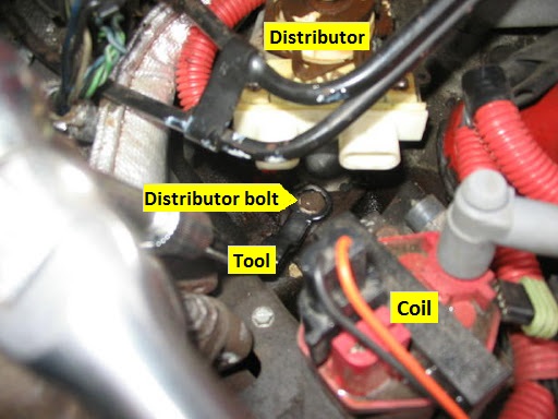

At the base of the distributer, there's a V-shaped metal piece (the distributer hold-down). The bolt is in the middle of it.
cvxjet
MAY 03, 01:41 PM
I have never had any problem finding the distributor mounting bolt- It is right at the base of the distributor.....But there are a lot of things in the way.
Here are some pictures to help........

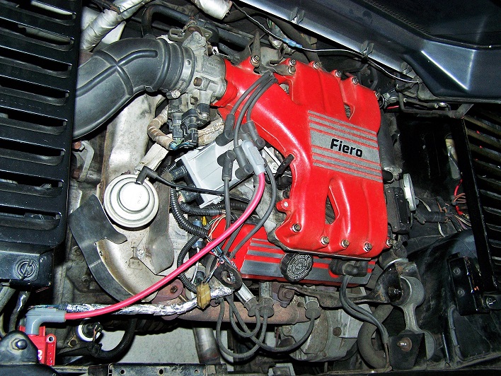

One of the reasons I removed the coolant lines to the TB was to facilitate easier access to the distributor.

The engine does LOOK better also without those lines- but in colder climes they might be necesary......
