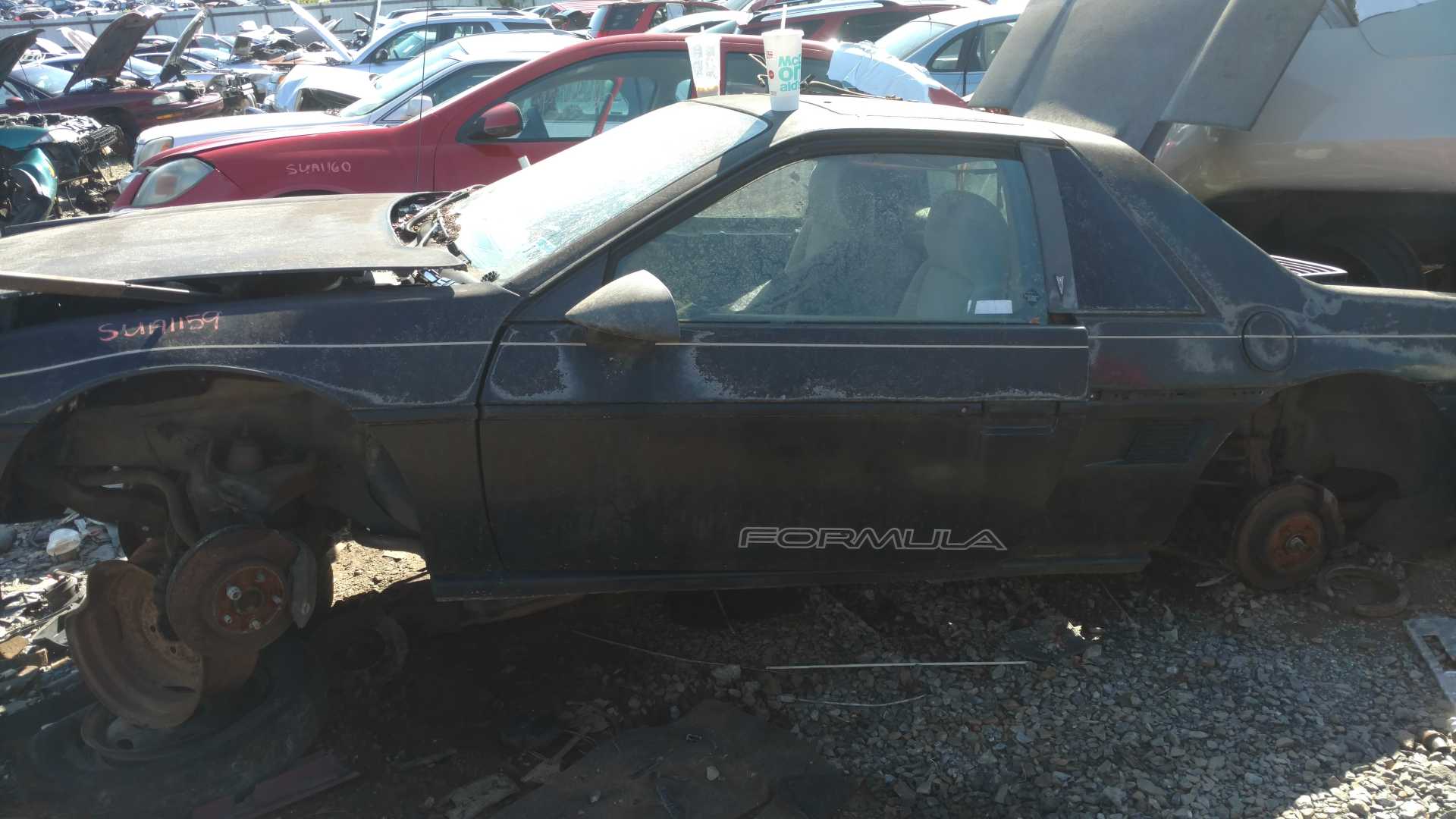

Came across a 88 Formula in a u-pull yard, decided to get the headlight system just to have for when mine quit working on my 86 GT. Harness had never been messed with, removed it and the motors and actuating rods. Never seen where it ever had the control module, wasn't in the inter fender wasn't nowhere, harness hasn't been cut nowhere. Went ahead and got it anyway, only 15 dollars. My question is has anybody seen one without the control module?  [This message has been edited by DirtyDawg (edited 05-03-2020).]

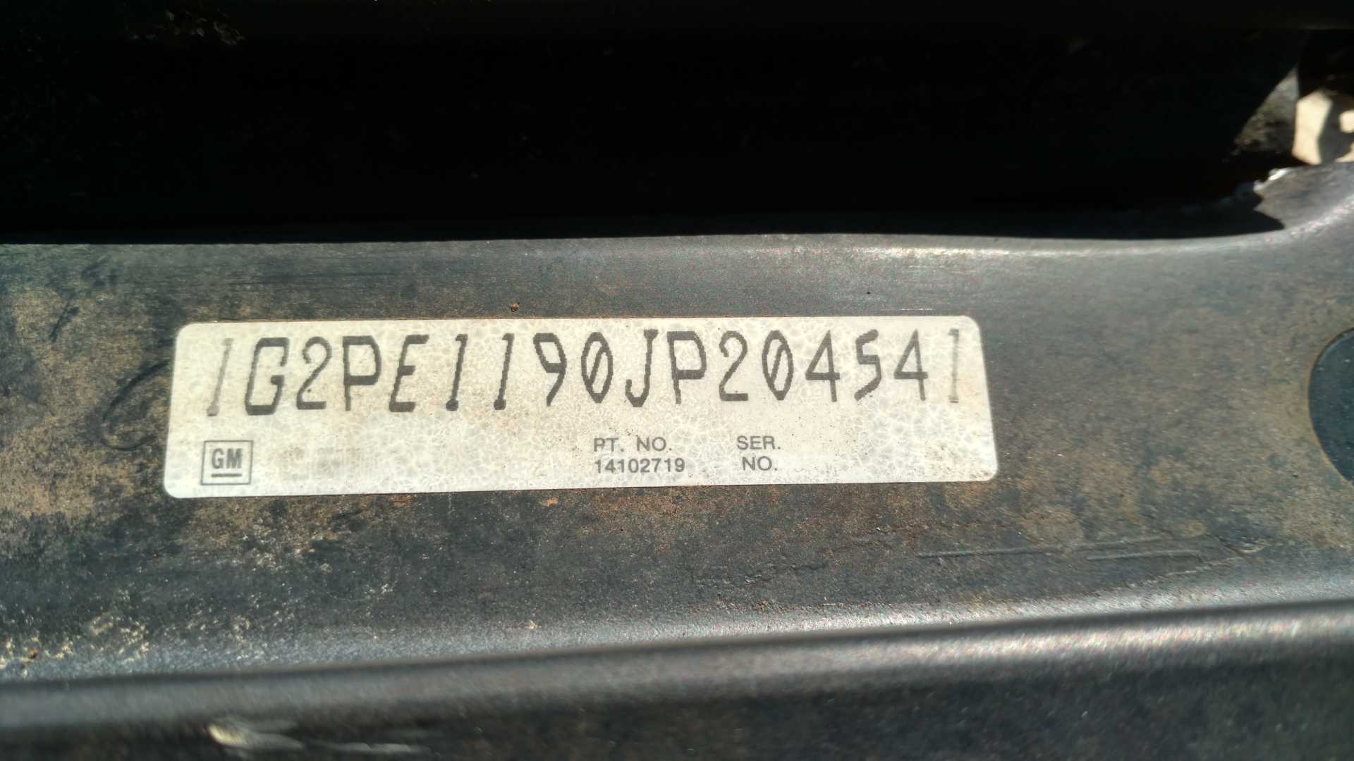

Did you happen to get the VIN on that car?
a few other parts should be saved.[This message has been edited by Gall757 (edited 05-02-2020).]

Nothing's been snatch, I posted the pic last, don't know why it showed up that way [This message has been edited by DirtyDawg (edited 05-02-2020).]

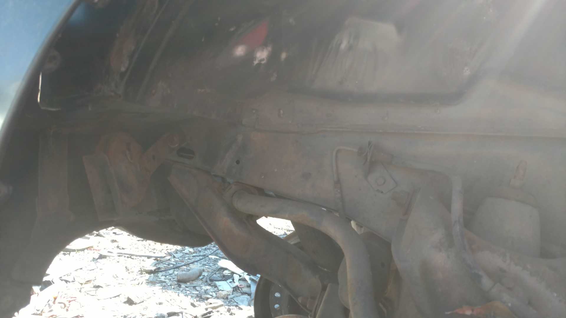

if it had been snatched there would have to be wires that went to it or signs of cut wires, there is neither. No holes in the inner fender where they are usually mounted.

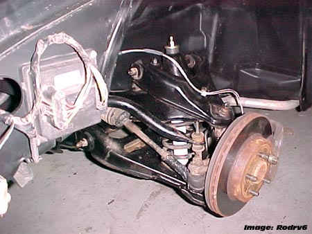

And there should be a pair of connectors that were located in the fender apron for the control module......The control modules are also hard to find so someone might have grabbed it.

If you look close at the pic there was no module in the fender. When I removed the harness there was only side marker light and one horn to unplug and there where no wires cut from harness. I can take a pic of harness to show it hasn't been messed with

Ok- So you are saying that the harness is different from your 86 harness- but that is has no connectors for the module in the fenderwell....That means you have a very odd Fiero- there were only two HL systems; The early one which was from 84 to 86, and the later better system that was in 87s and 88s.
Are there at least mounting holes for the module in the Formula's fender well?
