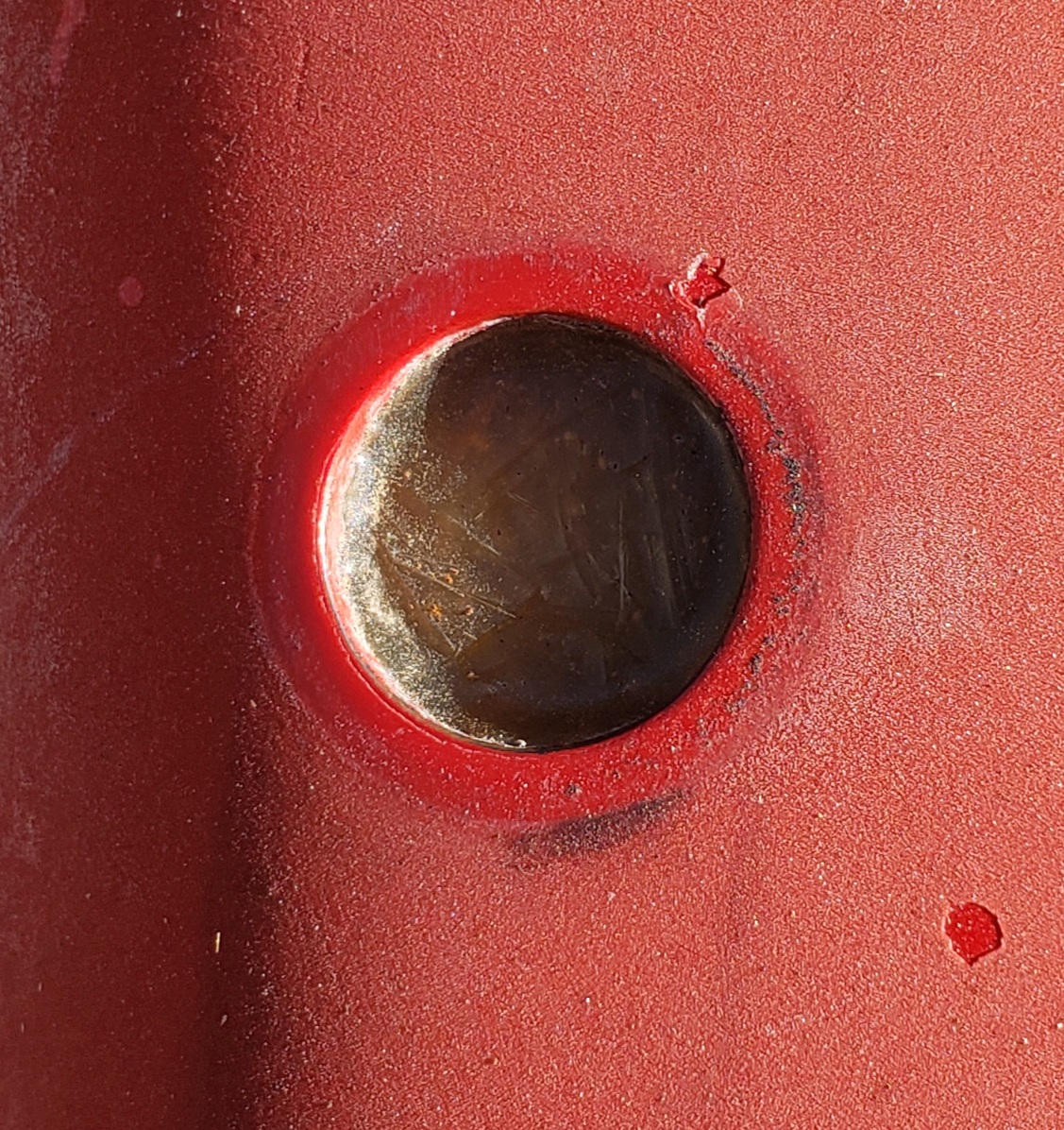

Hey guys & girls,
I'm going to be moving the antenna under the fender before I paint the car. My question is, what is the best way to fill the resulting hole in the fender? I'm thinking of using the fiberglass bondo, so would I need to reinforce the hole from the underside somehow? Is there a better way?
Thanks in advance.
