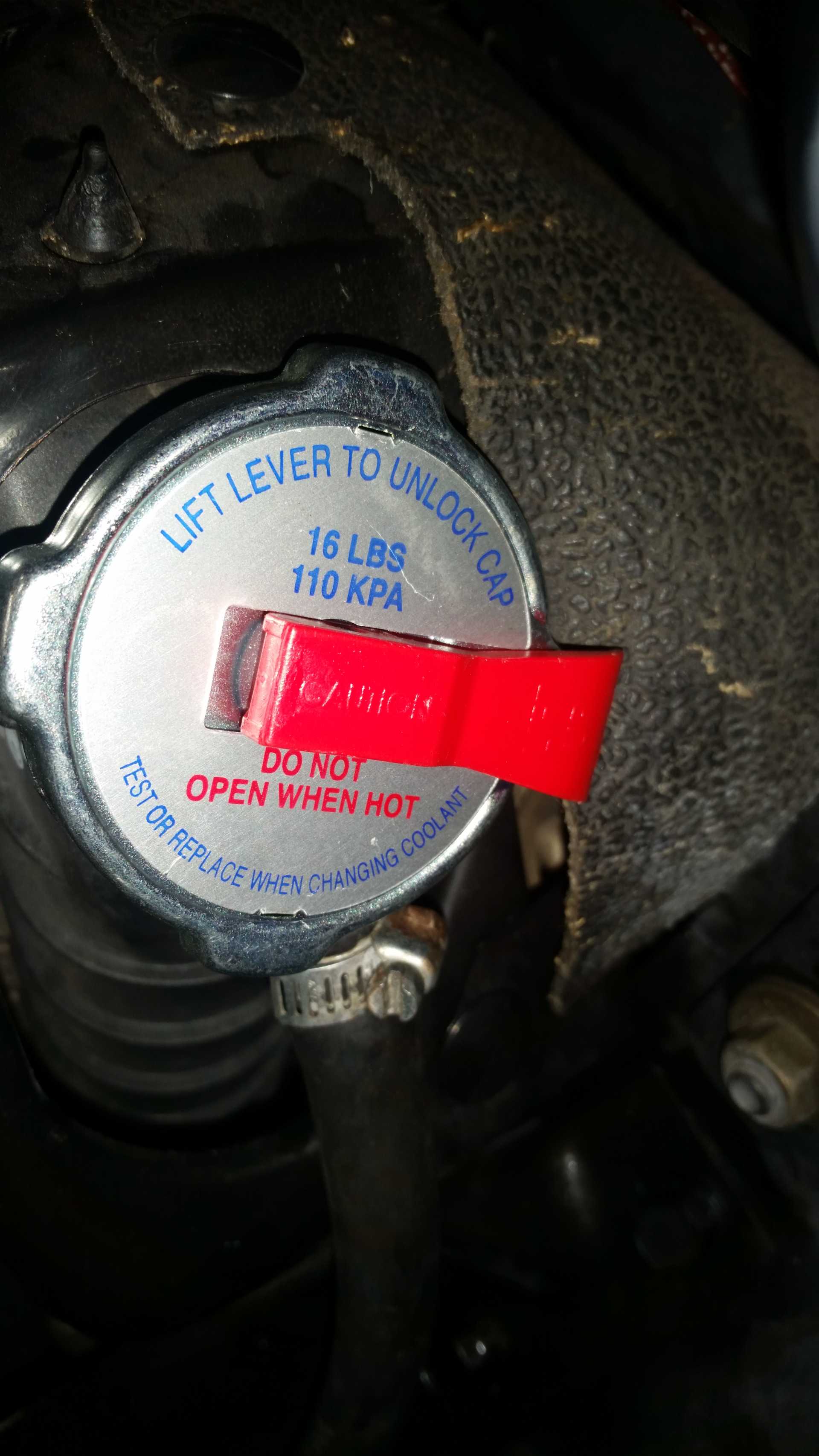

Got it home, the coolant hose at the passenger side coolant pipe had blown off. I'm wondering if I didn't tighten it enough, put the hose clamp at the right spot, or if the radiator cap I got wasn't the right choice. Subsequent reading on the cave said not to use a vented cap, though the stant that was on it before I started was a vented one showing the same PSI as this one.
