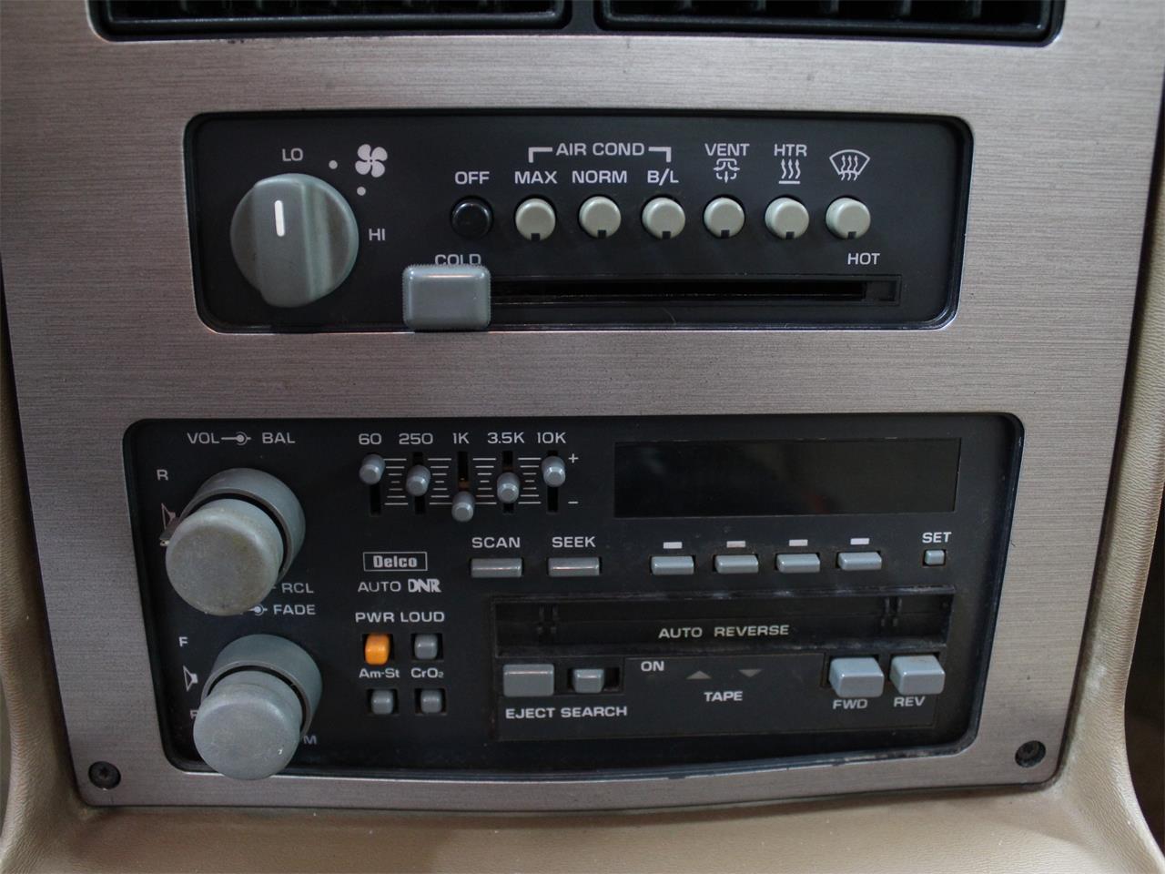

Thanks for the links. I have viewed them all. I can tell you for certain neither of my Fiero's had the factory radio plug cut as I remember when I installed the current aftermarket head units. Sad part is I lost my factory unit from my 1987 GT to a guy here on Pennock's early on when I was just getting in to Fiero's. The tape deck did not work. He was going to replace the belt. I sent the unit out. Never heard from him again.
I can clearly remember the one in the 1987. It is just slightly different from the links provided. I googled it. Here is a pic below.
