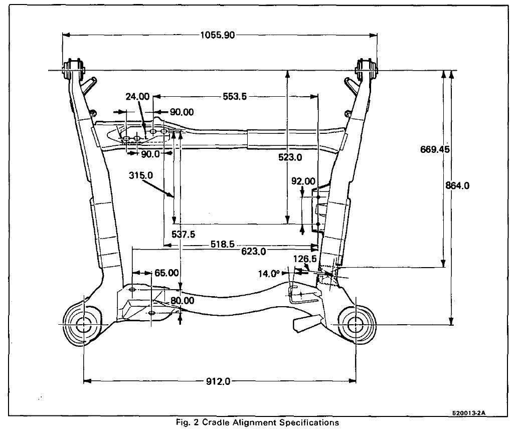

Make sure your "new" cradle is square, with no damage, before starting. I didn't check, and found the "new" cradle was out of square, and would not fit. It wasn't obvious just looking at it, but the rear cradle mounting holes were out of square about 1/2"- enough that I could not get the cradle to bolt up to the frame. Had to take everything off, redo the original cradle, and then re-install. ------------------ '87 GT , '00 3800 Series II SC, 4t65e, Vue Power Steering. (SOLD)
fierosound
MAY 03, 12:15 PM
| quote | Originally posted by darbysan:
Make sure your "new" cradle is square, with no damage, before starting. |
From '86 Factory Service Manual.
