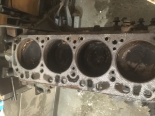

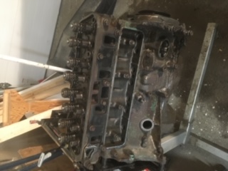

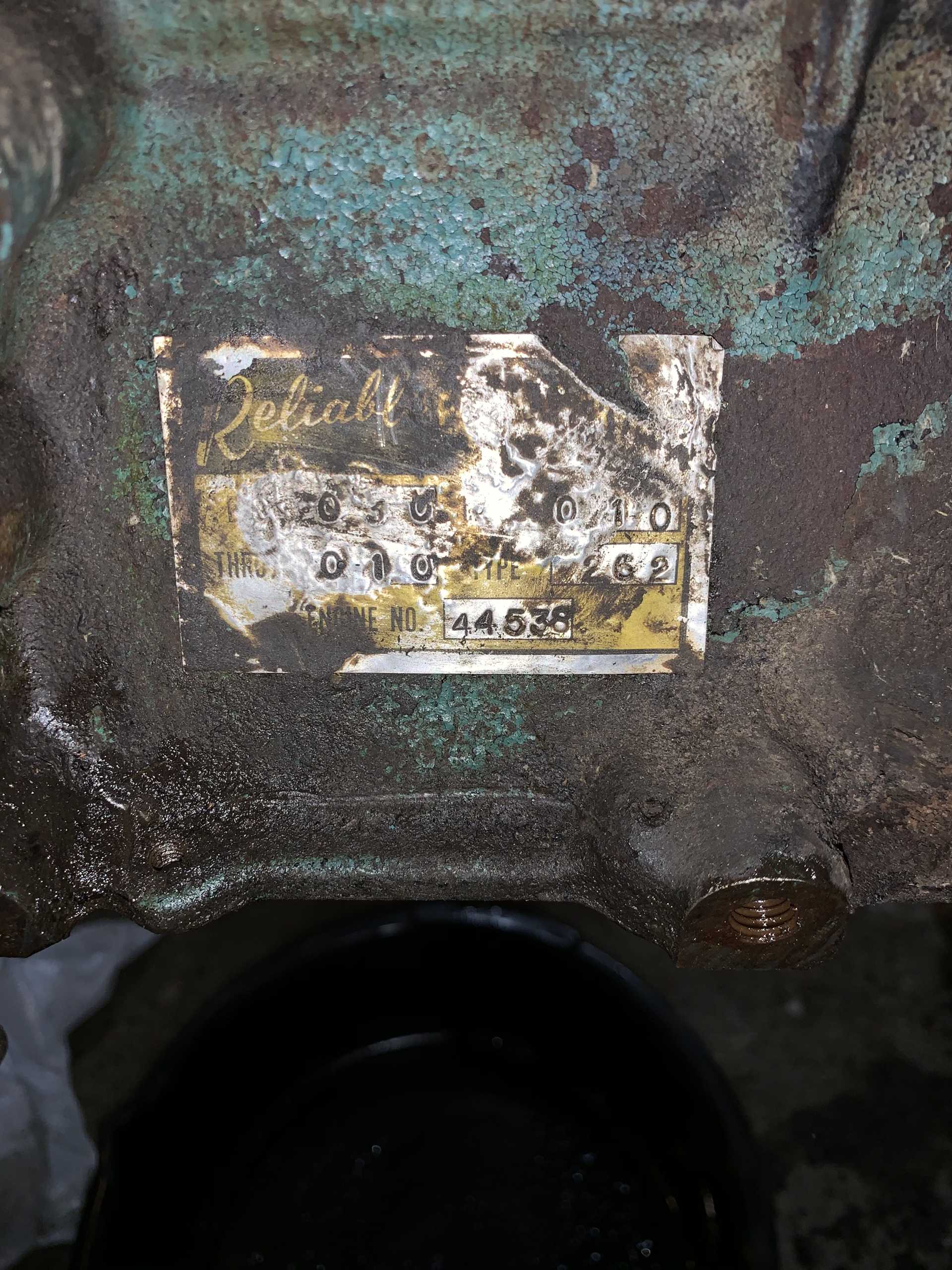

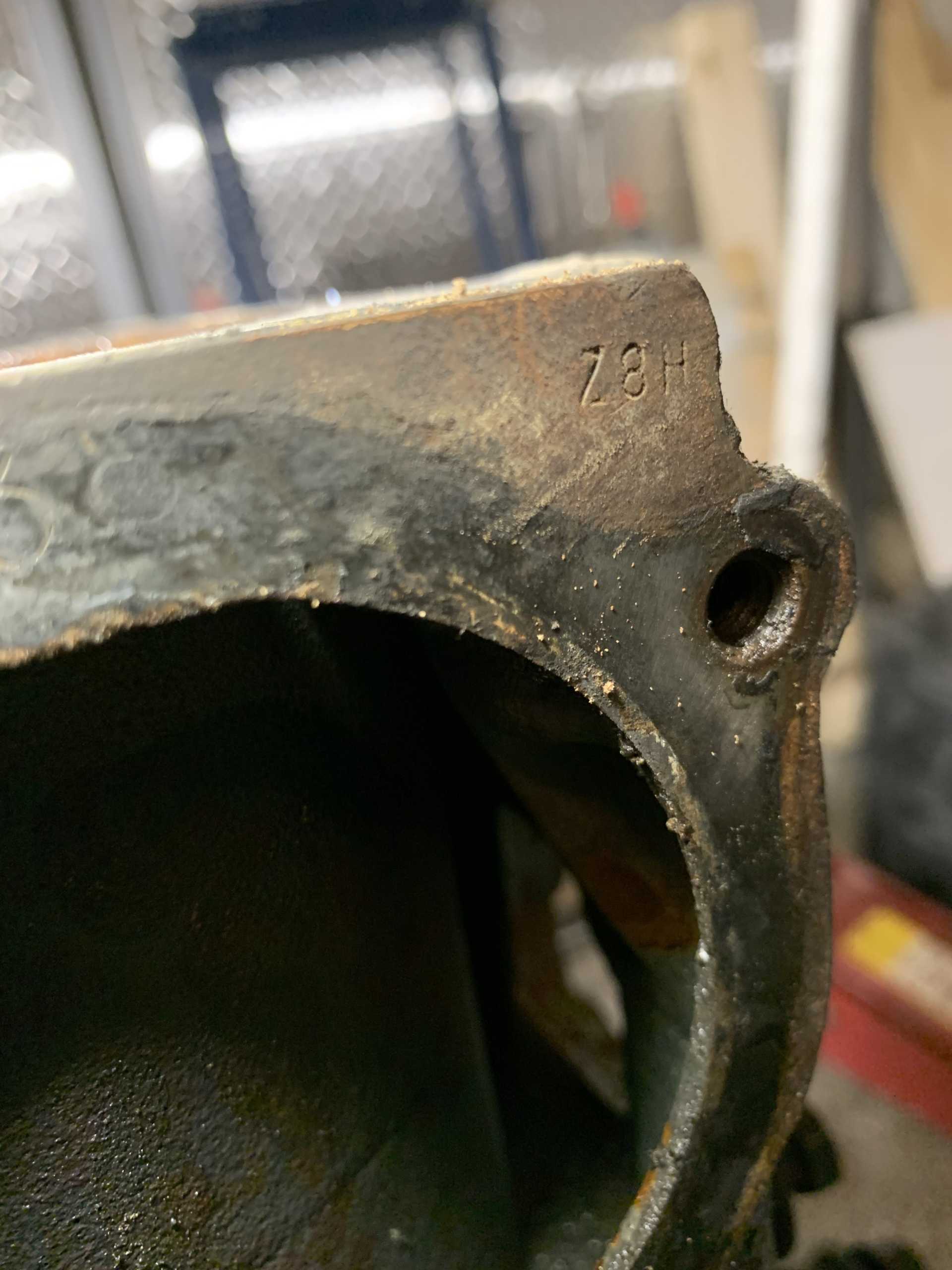

Hello all. Indy Fiero number 453 has come into my possession. However sometime long ago (pre 1998 as per the last registration sticker on the plate), the car got a new iron duke. I was hoping to find information about this engine, particularly where it came from, anything different about this engine over a Fiero one. Ive found the engine stamp, Z8H, but I cannot find anything online for this stamping. The other clue is that this engine is blue. As far as I can tell, all Fiero dukes are black, and I remember that the duke in my 85' 6000 was also black. This points me towards it being an older engine. Any help is greatly appreciated.
Attached pictures: Identification stamp, Re builders Tag, Block partly stripped, and the reason for this madness (edited to have more reasonable sized pictures)

General Motors was forced to replace a lot of engines in '84 Fieros. Looks like you got a remanufactured one.
APR 28, 02:43 AM
See my Cave, Duke Quick Ref
But this is been rebuilt by whatever aftermarket rebuild co. so you can't even order parts just for that and other Engine ID sites.
Example: If have "Head saver" shim w/ head gasket then block, head, or both have been decked to flatten it/them and cause problem if either/both needs more cutting.
Likely the mains, rods, Cylinder and more are over or under size cutting too.------------------ Dr. Ian Malcolm: Yeah, but your scientists were so preoccupied with whether or not they could, they didn't stop to think if they should. (Jurassic Park)

But this is been rebuilt by whatever aftermarket rebuild co. so you can't even order parts just for that and other Engine ID sites |
Agreed. Appears to have been rebuilt by Reliable Engine/Machine whatever by sticker on the side. Any good rebuilder will mic all the parts to see what's different from factory spec. before ordering parts.

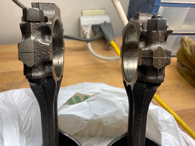

Thanks all. So its not worth worrying over the block. Now I did tear it down, and the rings where all broken so they need to be replaced at the very least, perhaps it will get a more thorough rebuild. But one more question regarding the connecting rods. The number 2 rod in this engine is slightly differently shaped, specifically the flats that the last shop stamped the numbers on. I'm pretty sure I am just getting worked up about nothing, but I better check for my own peace of mind.
APR 29, 01:32 AM
They reused or replace 1 rod or all from different source(s).
Broken rings is often mean they installed them wrong w/o proper end gap. IOW Rings get hot normally and break soon w/o that.
God knows what other corners they cut...
Better to just find 85 86 engine that runs then fix this. Even if has to rebuild later have a better starting point.
