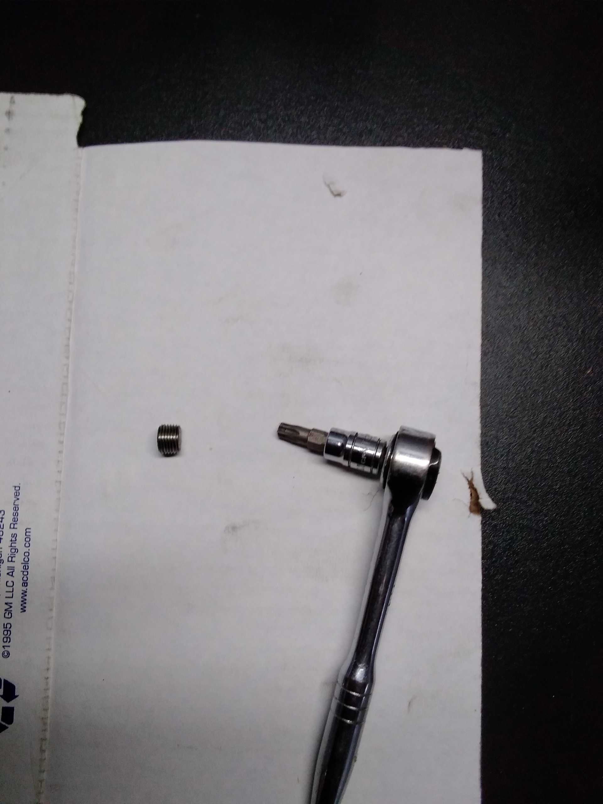

Drained cooling system by opening drains in the 2 ss metal coolant tubes under car (no problem; torx #30). Also opened rad drain; (not necessary and cannot catch the antifreeze). Total volume in bucket was 7 litres (6.2 Quarts), plus a little spillage, VS the 14 quarts capacity specified. Where is the block drain ? I installed the motor and do not recall any drain. I replaced leaking water pump and refilled system with plain water to test. Water remained at thermostat level overnight. I want to make sure all the water is out before I fill with antifreeze.

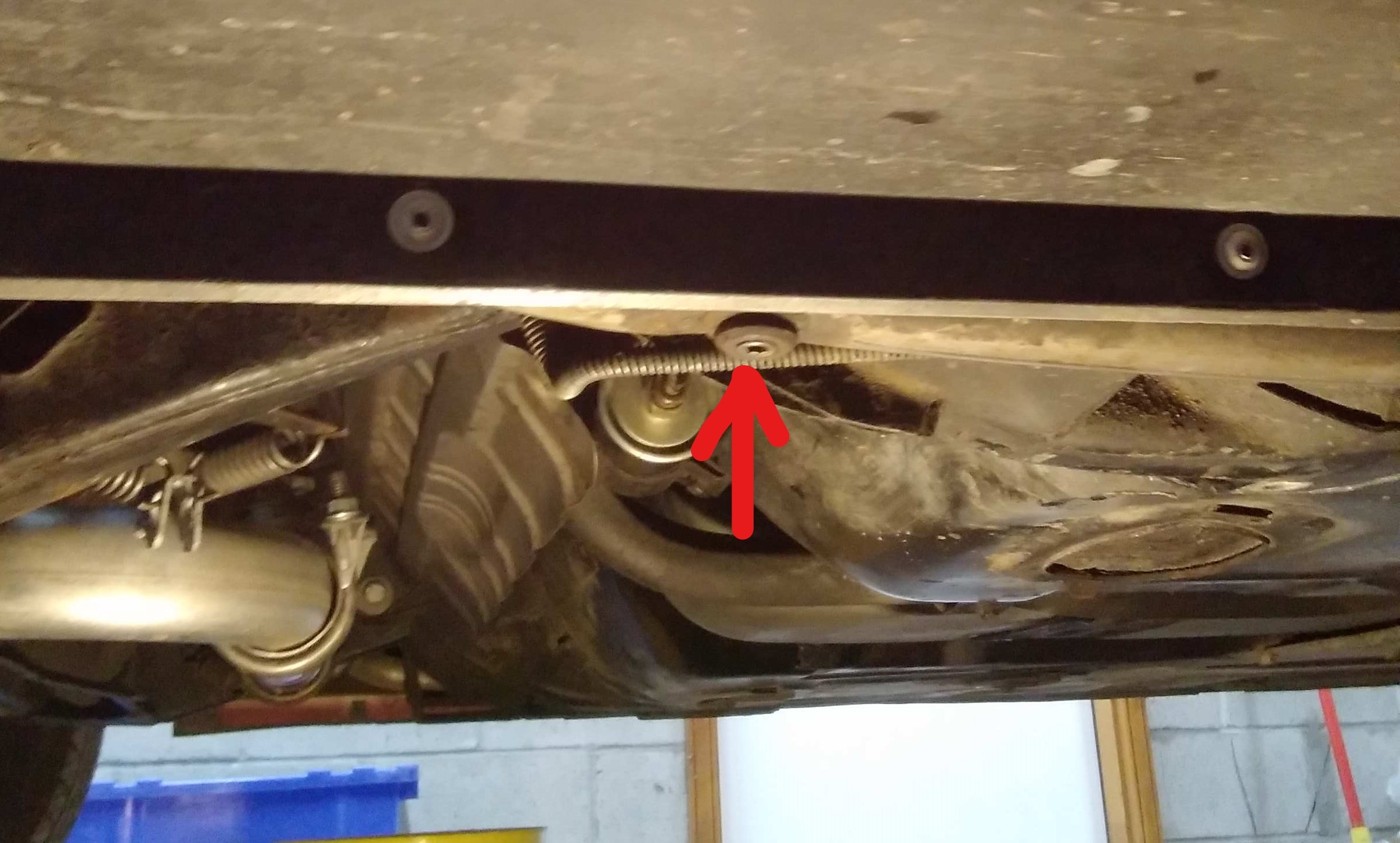

I got another litre out with compressed air. Per Ogre I will use straight antifreeze and test for concentration. Picture of underbody pipe drain port attached.

ENGINE Drain(s) are usually plugs low on block. Most I've seen are square drive that remove w/ ⅜" socket handle or short extension. Many are hard to find or access because many have other things over them. Most people don't bother w/ then because can leak, break, etc.
Big reason is Engine should drain part way w/o bother finding those drains if there. Engine and head(s) water should "Back flow" out of WP and drain to that level. WP doesn't have a check valve etc to stop this.
Do Not jack the car or parked noise down while draining. That keep coolant in lower pipes.
I drain P-side pipe w/ only T-cap off first. When flows stops remove R-cap. Then drain other side. That should get most w/o a mess. Then drain rad... If can find rubber/plastic tube fits short R-drain might help directing flow but most times that will make a mess. Could loosen clamps etc to mess w/ Heater loop to drain that part but big pain that may have problems.
If done that way, might suck coolant out of the overflow too. Regardless... Don't counting liters/quarts of drainage and think is an accurate value.
You need to 2 gal pure coolant in the system. You might get a system a little Coolant "rich" but better then have weak coolant trying to guess exact mix. (50% to 70% Coolant is ok for most brands.) If you can't get 2 in now, Completely empty the overflow tank and put the rest in there. System Should purge left over air and hot coolant and suck coolant back when system is cool/cold again. This can take several to many heat cycles to mix the system so testing a tank or T-stat can give bogus results until both see same number. Good thing you have Months before cold weather to worry about.
Most OE pipe drains are "Allen" holes. Exact size I forget right now. "rust," undercoating, dirt, etc. can change size. You might get lucky w/ T30 etc but can strip the hole and make worse problems. Or maybe someone replace the original plugs.
I use Teflon paint pipe sealer on pipe plugs in plumbing section of whatever store handy and don't force tighten. Any Sealers act as lube and easy to over torque them. More so w/ small size parts.
