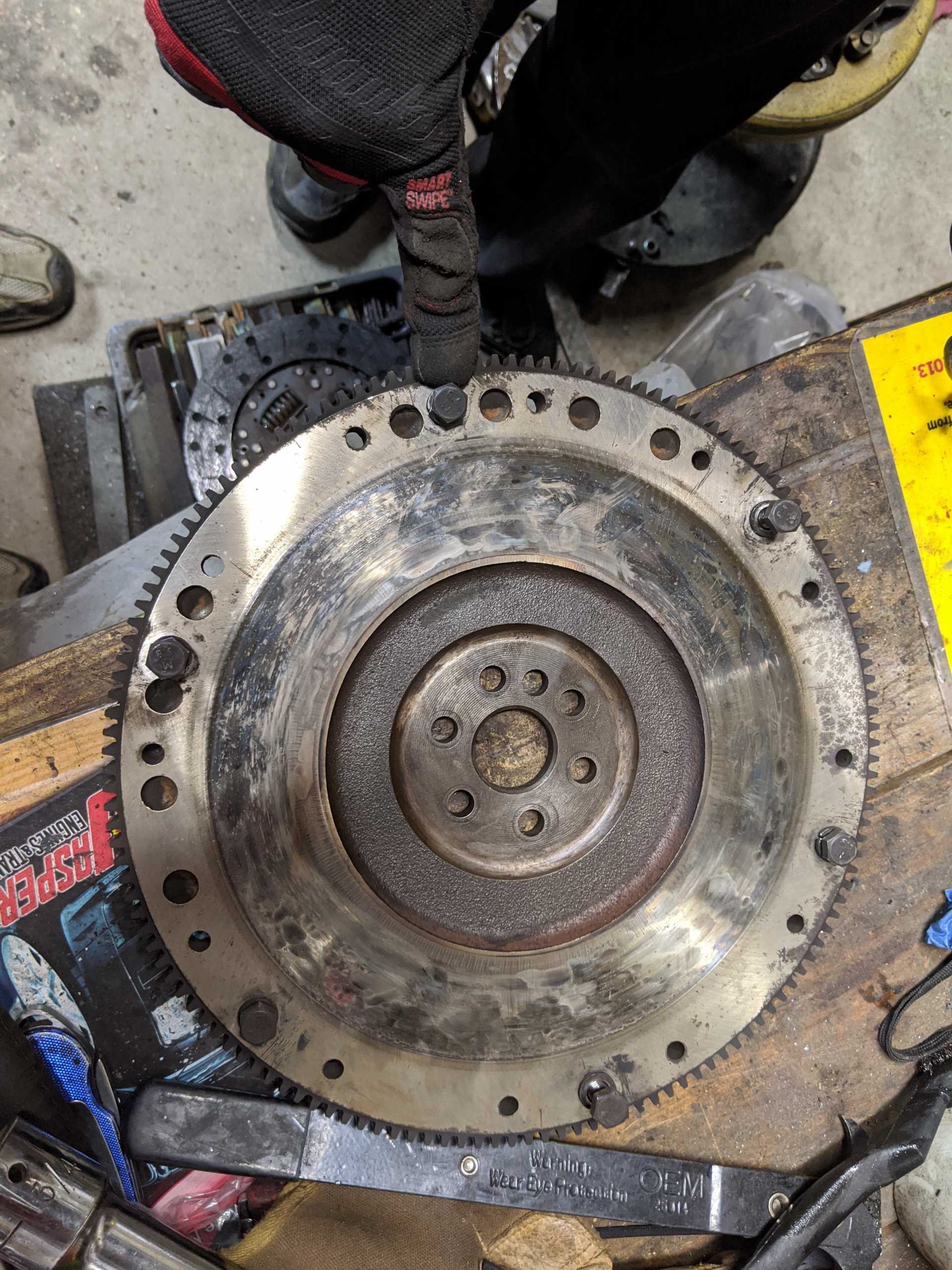

As luck would have it, we have an 86 2.8 four speed in the shop getting a new clutch. It has the original clutch in it, the flywheel has never been resurfaced.
There is no 'X' stamped into the flywheel. There is an 'X' cast on the back of the flywheel, but I discount that as the FSM clearly states the 'X' is stamped in the flywheel.
Questions..... Does your LUK pressure plate have a balancing tab on the cover? - If it does not, I would just install it and not worry about the alignment 'X'. Can you determine from witness marks on the flywheel the original orientation of the pressure plate? If using the FSM as your repair guide, did you not mark the pressure plate and flywheel prior to disassembly, as it states in instruction #2?
Here are some pics showing the cast 'X' on the engine side and the corresponding hole on the friction side.
Hope this helps out.[This message has been edited by olejoedad (edited 04-22-2020).]
Wow! Thank you! I have two flywheels and neither has the x on the engine block side.
I don't think it has a balancing tab. See attached pic.
Unfortunately, I did not mark it. I'm kicking myself. I took pictures, but they came out blurry. GRRR.
