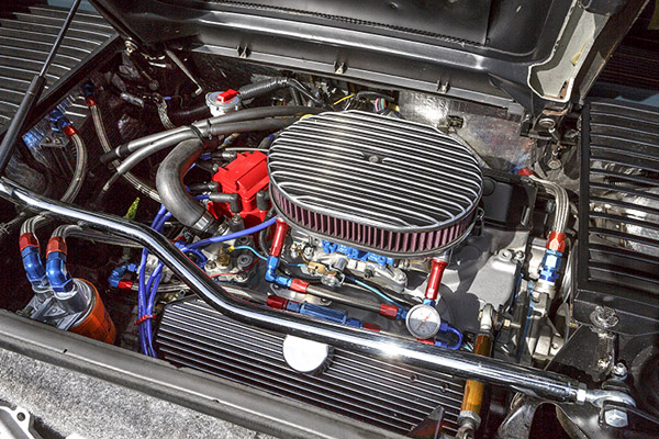

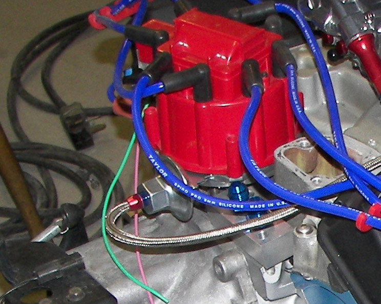

Johns 4.9 APR 23, 02:25 PM
Hi,
I have a remote oil filter and oil cooler on my 4.9 engine. I removed the oil filter housing and made my own mount with AN- fittings. Not necessary, but makes oil changes and track days easier.

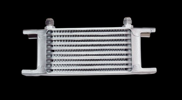

Thanks all for all the great suggestions. Upon checking those oil cooler fittings on the oil filter housing they measure up more like M18 x 1.5 O ring to #6 AN fittings. I ordered adapter fittings today and hope that they work. I will use this cooler
and #6 AN SS braided hoses
