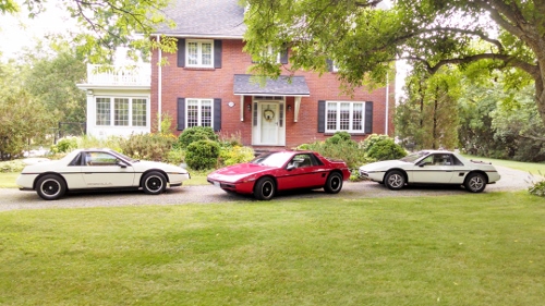

I've been daily driving a stock 84 SE 2.5L 4 speed since new, now with over 384,000 kilometres (238,600 miles) on it. I don't take it out of the barn when the roads are salty. (Other cars are used then.) I have an alternate daily driver; an 86 coupe 2.5L 5 speed that I got in 2011 in case the 84 went down for prolonged repair (since I seem to be slow...) It has 144,000 kilometres (89,500 miles) on it. Each has been out of service while I attended to issues, so I still had a Fiero to DD. I got a stock 88 Formula 2.8L 5 speed in 2008 with 5,200 kilometres (3,230 miles) because it was in showroom condition and who wouldn't like that? It's for shows and occasional drives.
IMHO for normal driving, the 84 SE with the WS6 sport suspension corners as well as the 88 Formula with the revised suspension. Other opinions vary; particularly track drivers. Tires are a factor there too. The 86 coupe feels softer, but it's still fun and corners well enough.
Here's the fleet:
