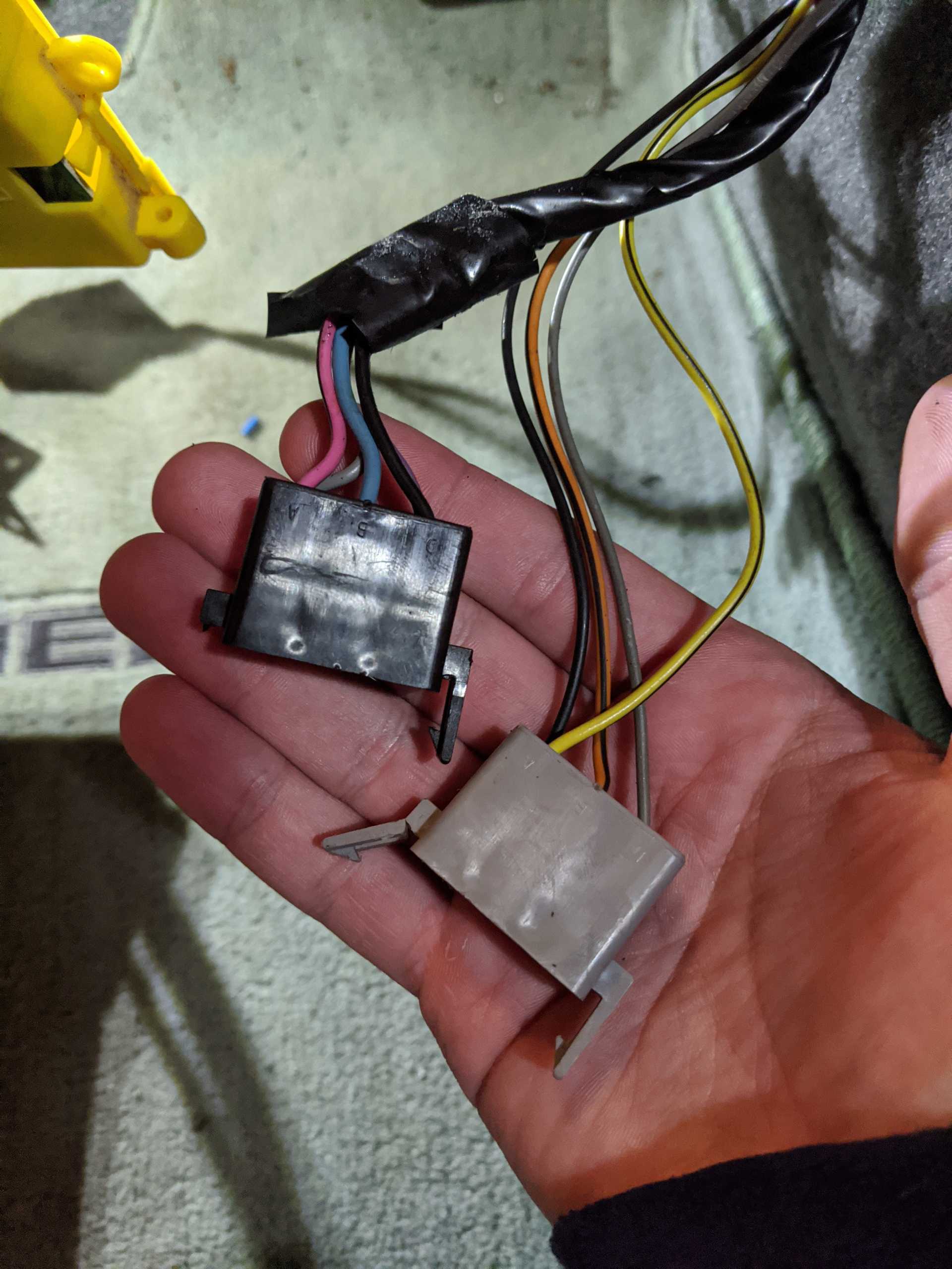

On a side note, when removing the cluster I found a grey plastic female plug with 5 wires going into it under the shroud on the right side. I couldn't find anything that looked like it should plug into. What is that? I can post a picture tomorrow if needed.

Is the the plug? If yes, my gray connector has four wires and goes to the trunk release. My black connector has five wires and goes to the defroster.

That would make sense as my car is a Formula with neither rear defroster or trunk release.
