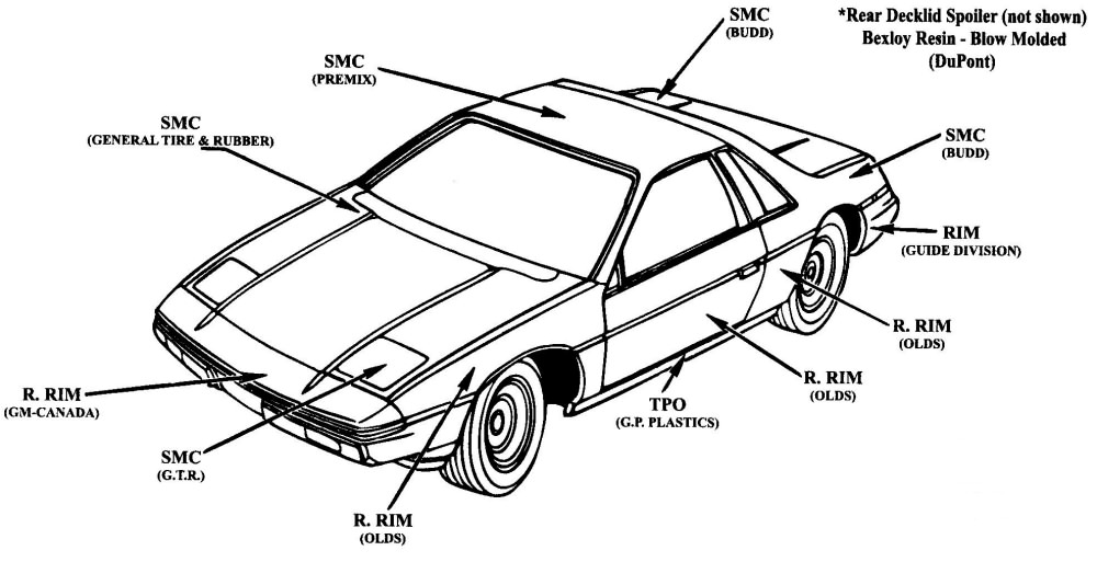

The paint on the ground effects on my '87 GT is pretty well chipped at the top edge in several places. I thought I would sand the chips, use filler to level things up and repaint. However, when I tried to sand, the paint is just flaking off, I can even pop off chips of paint with my fingernail. Obviously I need to remove the panels, strip them and start from scratch. I have repaired and painted fiberglass on the Mack trucks that were used in my business but I'm not sure what kind of plastic the ground effects are and need to know if there is anything different about preparing and painting them as opposed to fiberglass. All help appreciated.

I don't believe that stripper has been used as the exposed bare plastic shows no signs of damage, not even sand scratches. What kind of plastic is this stuff?
Gall757
APR 19, 02:26 PM
TPO

I believe the parts are thermoplastic, not SMC or Fiberglass. ABS plastic never needs any kind of primer...just scuff sand and paint. ABS is mostly used in aftermarket parts.
NEVER use any kind of stripper on ANY kind of plastic parts. Ive seen guys total a Corvette body using stripper, EVEN when it says safe for fiberglass. All you can do with it after is junk it and find another one.
Proper sanding is always best with 320, 360 or 400 grit...not necessary to wet sand, dry is fine. Adhesion promoter is primarily meant for soft plastic/vinyl like door panels, armrests, etc. No need for it on any outside body parts. Just sand, prime if needed, basecoat and clearcoat (or single stage).
