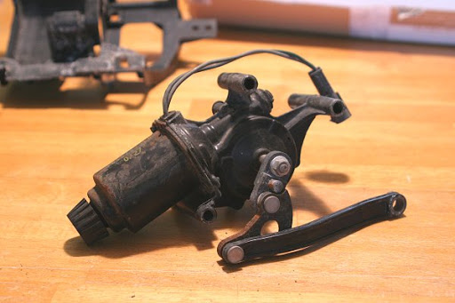

ive looked through all the threads i can find on here even reducing my search to just headlights, but all i can find is how to fix them but not how to tell which i have i have an 86 SE 4cyl, it seems that in 86 it is hit or miss as to what was factory for the car. can anyone point me in the right direction as to which one i have?
APR 12, 05:35 PM
Gen 2 headlights were introduced with the 87 model year.
They feature a smaller knob than the Gen 1 and have no relay on the headlight mechanism support bracket.

The generation one headlights had a larger knob, and there were two holes in the top of it. The Gen 2 knobs were smaller, and no holes on top

Gen one motor, square knob
Gen two motor, tapered knob
