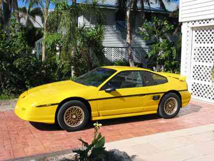

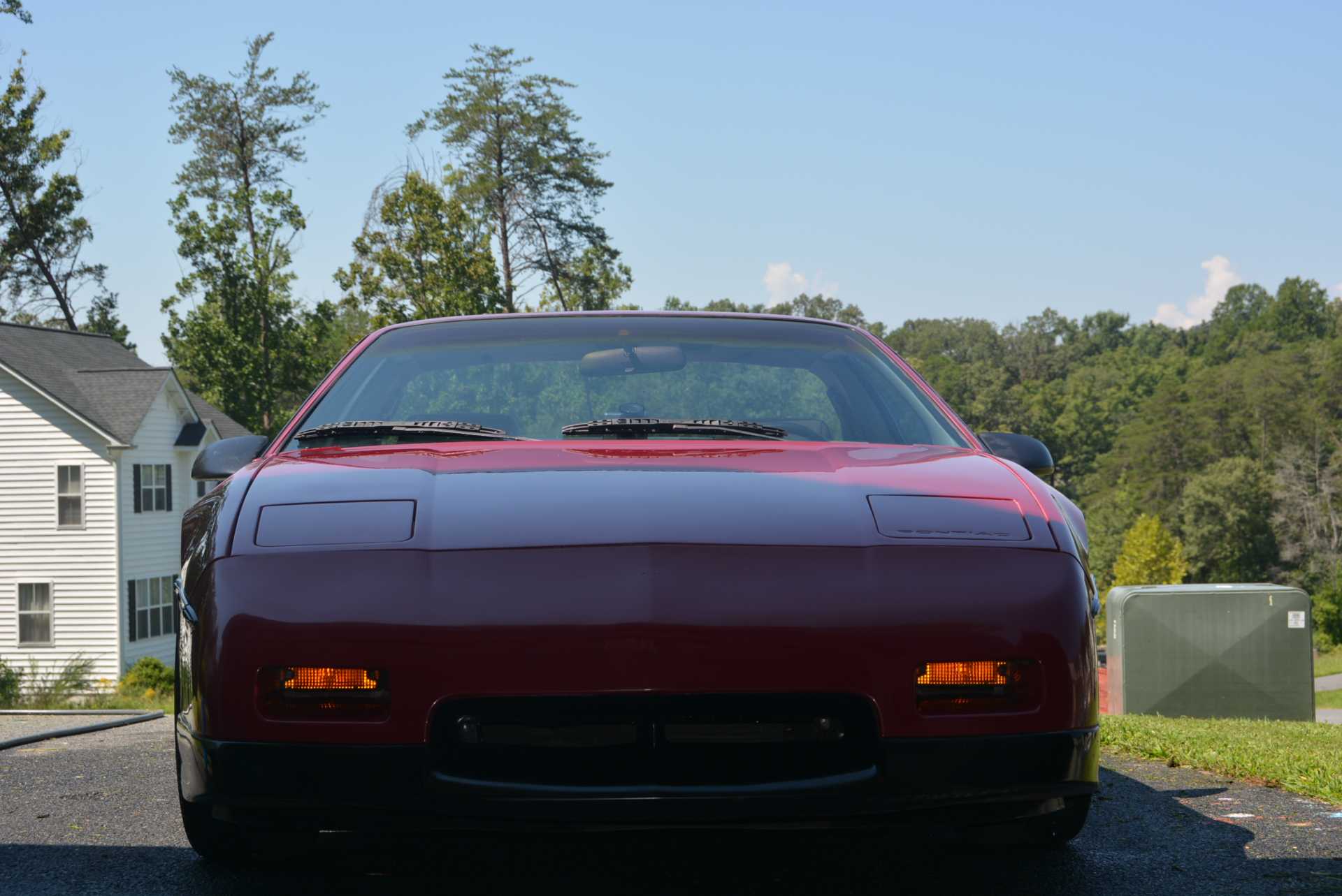

So what is the procedure of painting a car roll on style. I want a yellow fastback. I seriously hate that gm did the silver two tone look on the 85-87 cars 🤦♂️ Should of done just a solid color imo. Here is a picture of what I’m looking to do I’m going to keep my spoiler black and as well my aftermarket sails, mirrors and trim

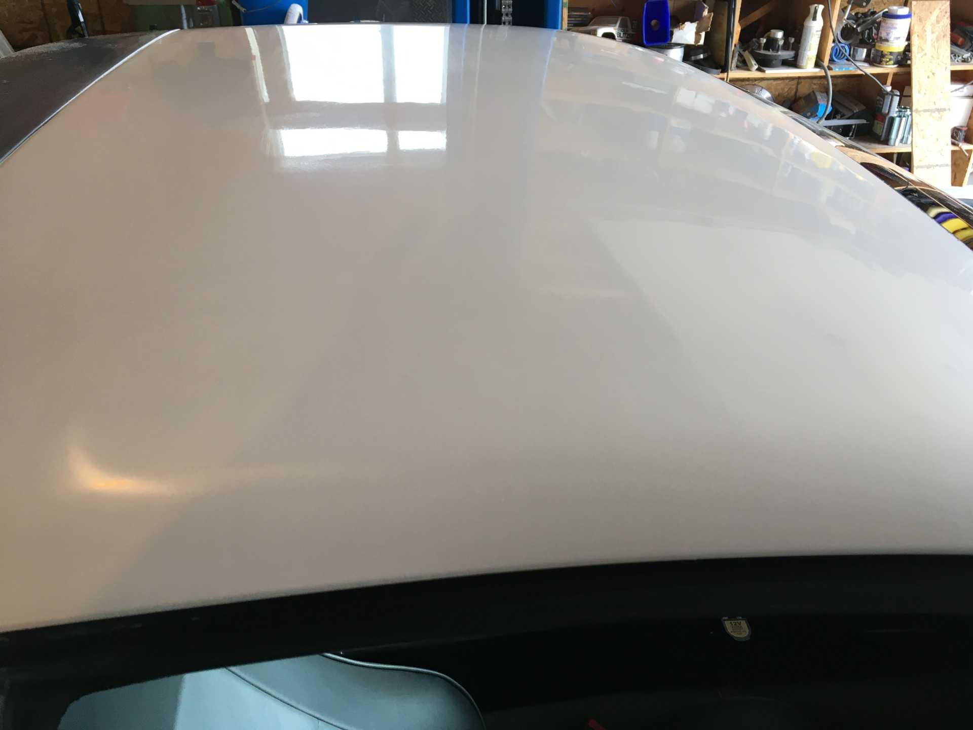

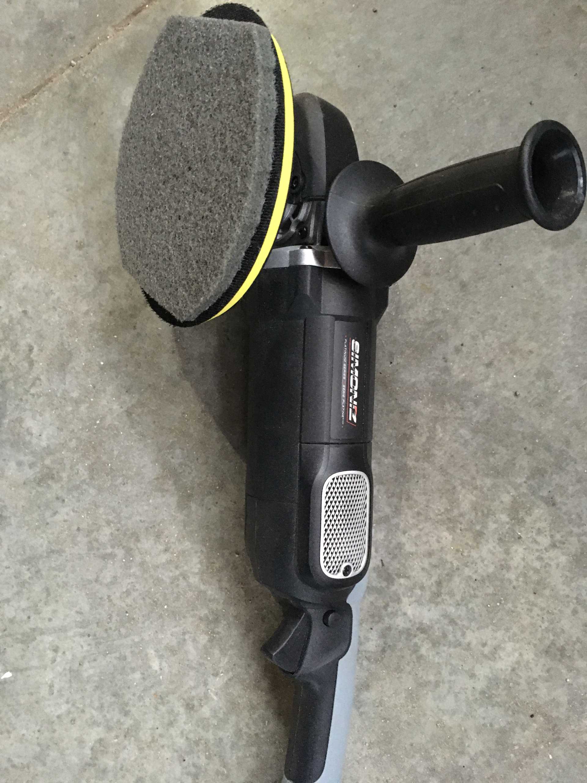

This a polisher with a hook and loop style base. Note: it is a variable speed polisher set at second lowest speed. A fine synthetic steel wool pad will stick to it. After about a 400 grit wet sand, I used my polisher to bring up this finish:
This was painted with rattle cans but I think you could do the same with a roll job[This message has been edited by wftb (edited 04-12-2020).]

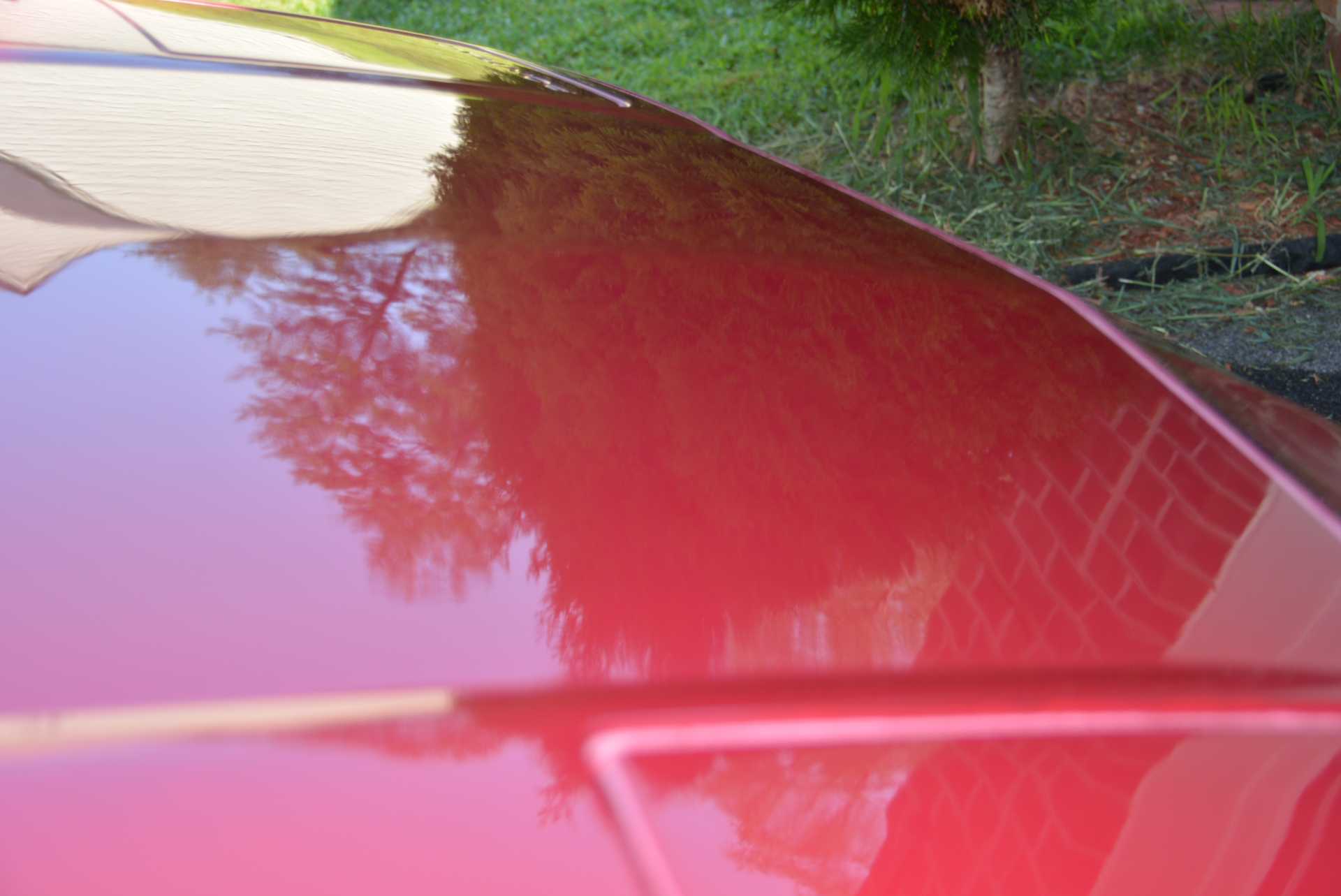

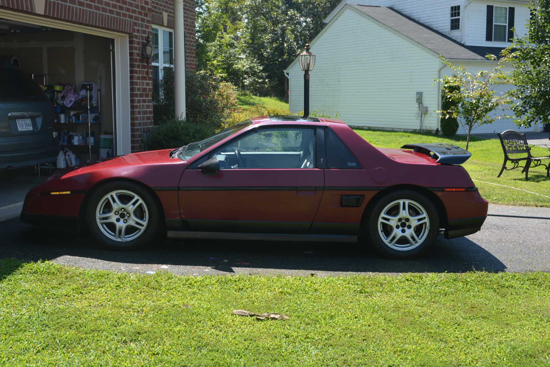

tnkgnr
APR 12, 08:35 PM
