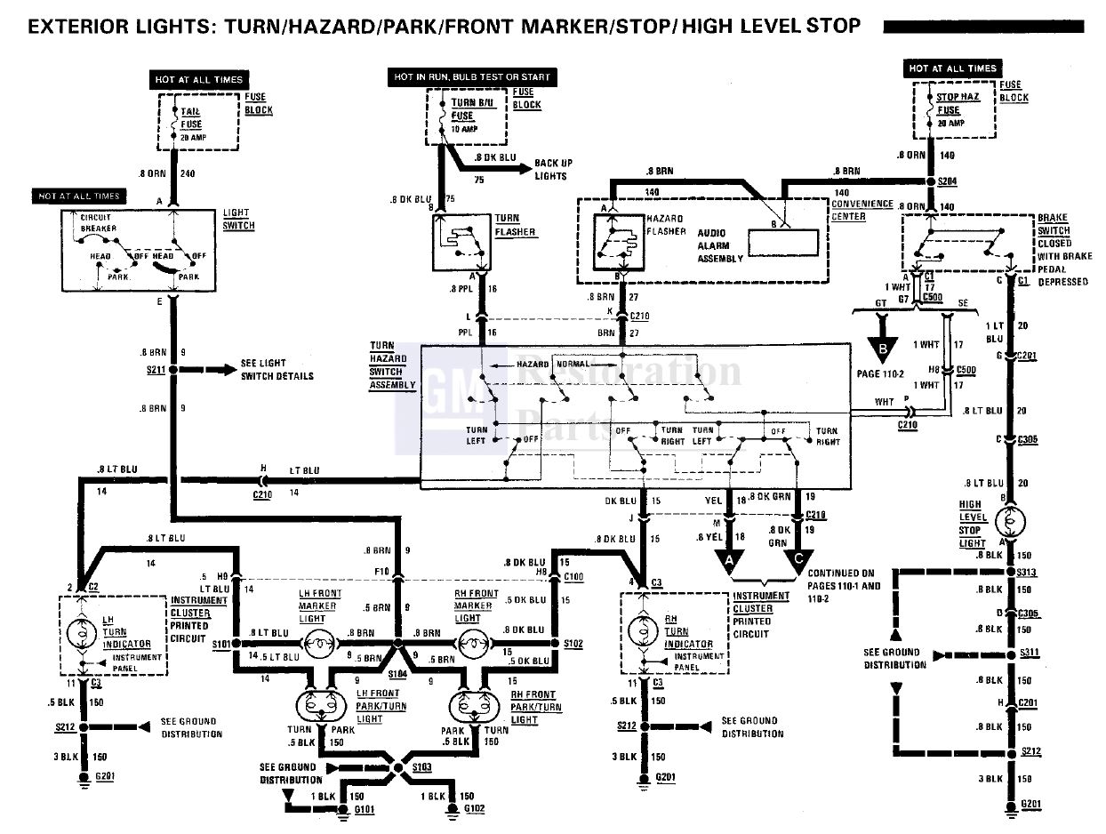

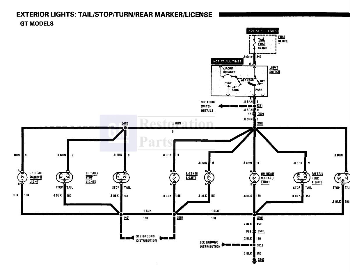

I just noticed that when I apply my brakes the front parking lights and both front and rear side marker lights light-up. After checking all wiring schematics I can't find where they are interconnect except maybe using the same main ground. I was hoping if someone would check this on their car to see if it is normal or not on a 88 GT. [This message has been edited by Imnuts (edited 04-10-2020).]

I think you have 12V from the STOP side of the bulb jumping to the TAIL side when you press the brake. That feeds the side marker, which is part of the light switch circuit which controls the front lights too. A tail light bulb with filaments touching will do it.

84-87 Brake pedal turn on Front lights is something way wrong then a iffy ground. Because normally Two circuits are not connected to each other.
But
88 Rear lights ground inside of cabin and may have a Sneak Path sim to my Cave page. 88 GT has separate rear brake and turn bulbs so even that should be very hard to do w/ iffy bulbs... Maybe you have rear lights "mod" and F'd up the wiring or have sockets w/ iffy ground, or wires pinched somewhere in cabin or rear.
Could also be iffy Turn switch or wires to that like Wires pinched, T-switch is F'd, etc. Make sure Hazard button is release... Is part of T-switch and may do weird things if pressed. If true, Maybe hazard flasher is bad too. The flasher can next to chime unit.
Pull taillights assem out, pulls sockets, push brakes while watches the bulbs. Should only light 1 filament and only for brake bulbs.
More Need 88 FSM or Alldatadiy.com because external lights power and ground "maps" etc are spend over several pages. You can't use older data for 84-87 Fiero.------------------ Dr. Ian Malcolm: Yeah, but your scientists were so preoccupied with whether or not they could, they didn't stop to think if they should. (Jurassic Park)
