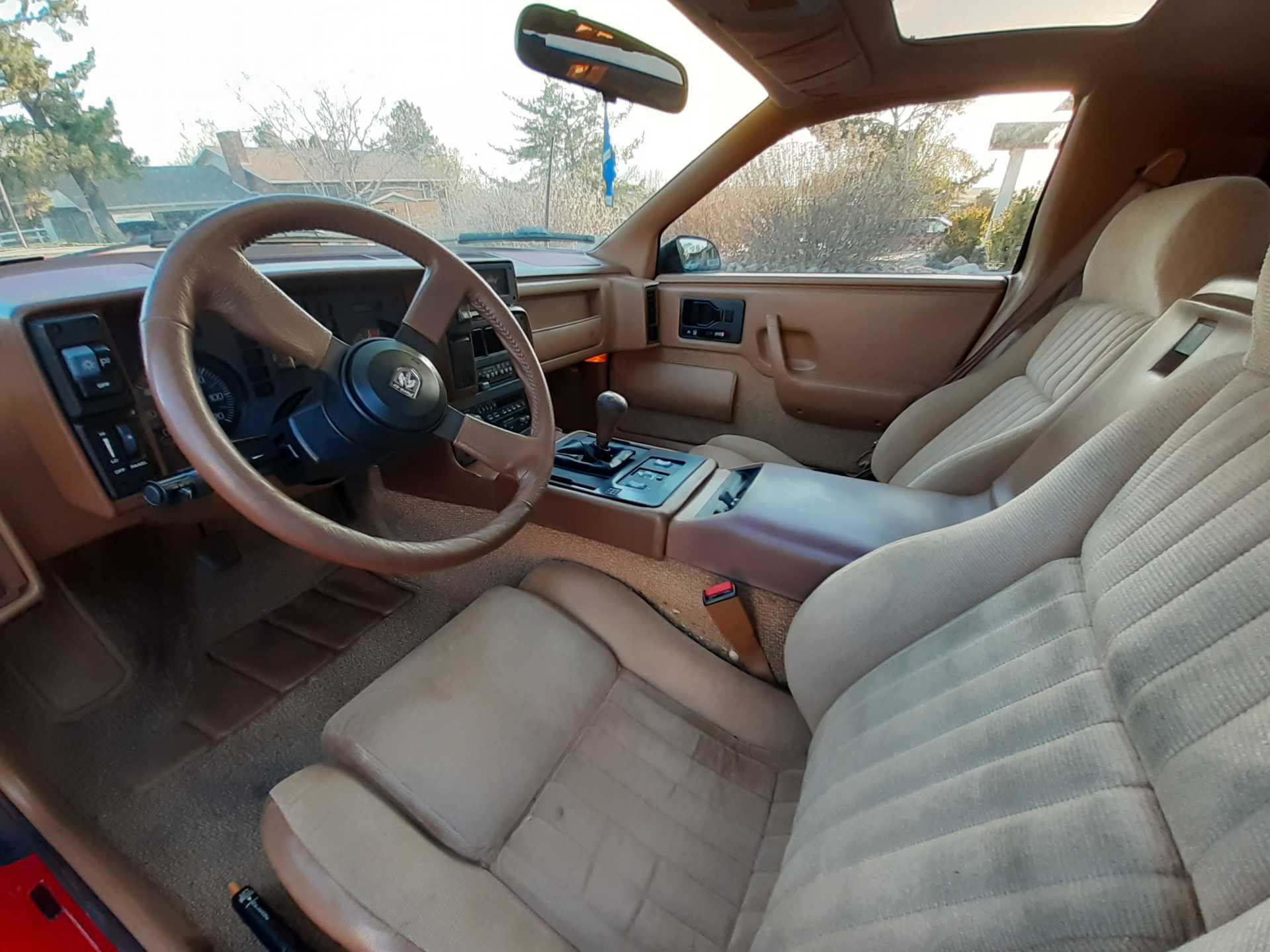

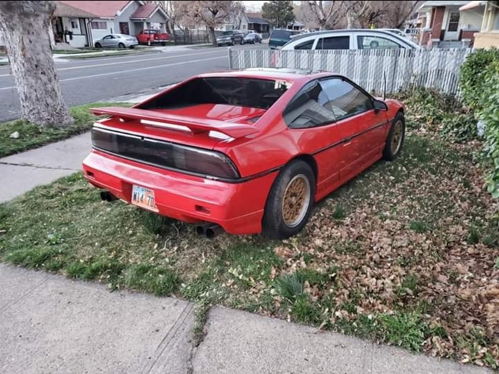

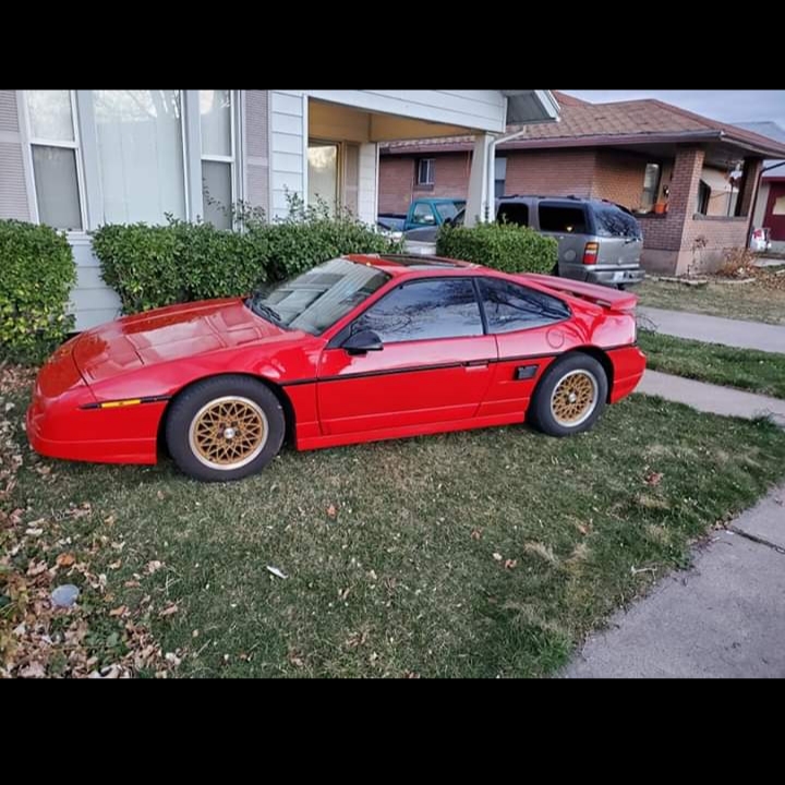

So what do you guys think? Its unlike anything I've encountered before. Oh and here are some pics, 57k original miles but really needs cleaned!
