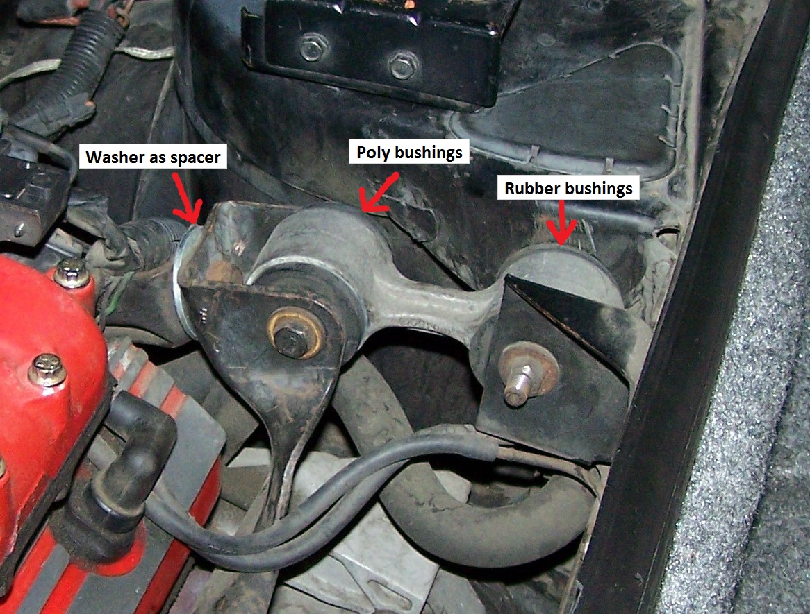

I just measured my 85 SE V6 dogbone- Both Center-to-center (3 3/4") and overall length (6").....
Here is a pic of mine; I have Poly in one side....and my engine had to be tilted a little to make it fit- so I installed a 1/8" washer to get to neutral point......

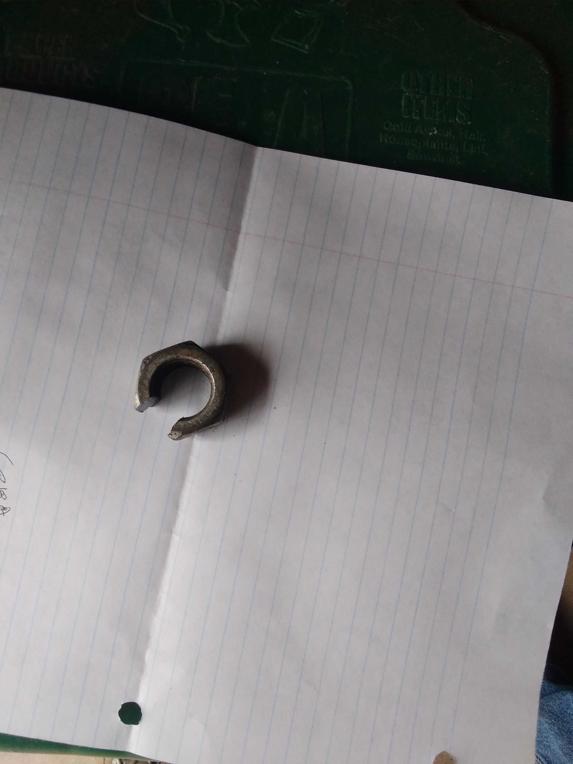

I installed spacer. The Dog Bone bolt slid right in. I had difficulty in threading bolt thru spacer therefore installed bolt first and inserted spacer cut to "U" configuration. Rubber bushing OK, otherwise I would have bought a suitable dog bone; West Coast Fiero custom length $65, Rodney Dickman Fiero, adjustable solid/no bushing $65. (Dickman has an adjustable Dog Bone with poly bushing but max length is 4 1/8")
